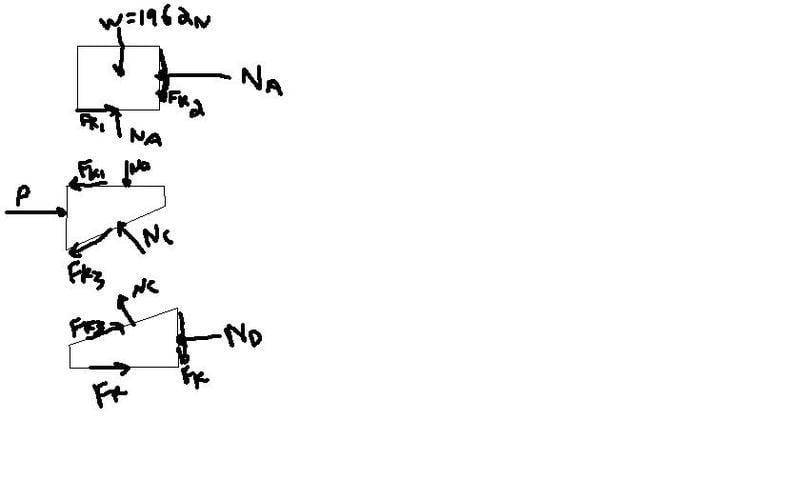

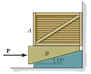

Determine the force P required to like the 200kg crate. Coeff. Static friciton is 0.3 on ALL contact of surfaces. Neglect Wedge Mass
μS x Fn = Fk
Summation of forces eqns
im getting more unknowns than equations
see attachment.
You should be able to get the friction force due to the B wedge moving on the crate surface quite easily. Do that first!
For the next surface down, can you find the normal force? Both the weight of the crate and the P force contribute to it.
haha ofund it actually. muFN = Fk so uu only have 2 variables. gah well thanks anyways
