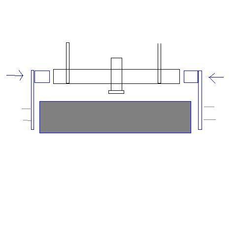

I didn't see it in the posts but I'd be more worried about the torsional stress. I think the square tube would hold the load static but I doubt a single point will last long before it twists like a corkscrew.
I saw a mount on a jeep a few months back that came out either side of the 3" hitch cross piece. I did a quick drawing of it. The side pieces bolted to the tray. It didn't look like he had done anything to the hitch, just plugged it in.
Thank you for your reply, I think you telling me that you are concerened about the main tube twisting between the two flanges that attatch to the frame? I don't know how to send you a drawing of what I plan, but my thoughts are to extend the receiver tube on the same plane about 3 feet forward then attatch another cross member from frame rail to frame rail, also gussetts will be added to the existing cross tube to the flanges.
