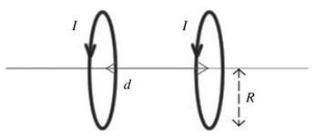

Two coaxial circular coils of radius R = 15 cm, each carrying 4.0 A in the same direction, are positioned a distance d = 20 cm apart, as shown in the figure. Calculate the magnitude of the magnetic field halfway between the coils along the line connecting their centers. (μ0 = 4π × 10-7 T ∙ m/A)
Diagram of two coaxial circular coils side by side on a horizontal axis, each labelled I with arrows showing the same direction of current; the gap between them is marked d and the radius of the right coil is marked R.
Equation for the axial magnetic field of a single circular loop: B = μ0 R^2 / (2(R^2 + x^2)^(3/2)), with μ0 in the numerator and the exponent 3/2 on the denominator bracket.
so:
B= [(4*∏*10-7)(4.0)(0.152)]/[2*(0.152+0.22))3/2]
which is = 3.62 x 10-6
not near any of the options.
Is this a very wrong approach?
Thanks!

You are only considering the field due to one of the coil at a distance 20cm from its center. But you are asked the total magnetic field due to both, halfway from their centers! So fields from each of the loop will add. Remember to check the field direction due to each before adding, as it is a vector.
