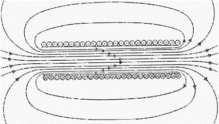

The solenoid's field is something like this:
(from ar.inspiredpencil.com)
Your phone's magnetometer needs to be correctly aligned parallel with the field. You might be 90-ish degrees off if you simply point the phone at the side of the solenoid. You need to check.
Note that if the earth's field and the solenoid's field at the position of interest have different directions, you need to allow for this: you need the difference in readings (solenoid on/off) taken with the phone aligned with the solenoid's field.
If all that makes sense!
Thank you! That does make a lot of sense actually, when I did the measurements earth's magnetic field was arond 38 microteslas and It could get up to 65, so maybe that has to do with it. Also, it is true that when tilting the phone when testing with earth's field it went up or down depending on the orientation (absolute value), I didn't think of that. I will definitely check that, thank you for the help!
