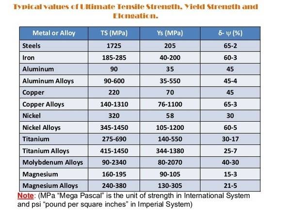

Is there a reason you have chosen chrome as the material for this application? I would think there would be better material choices for such a heavy load...?
https://qph.fs.quoracdn.net/main-qimg-66583d1159eeb1af4630118ef7003c2f-c
