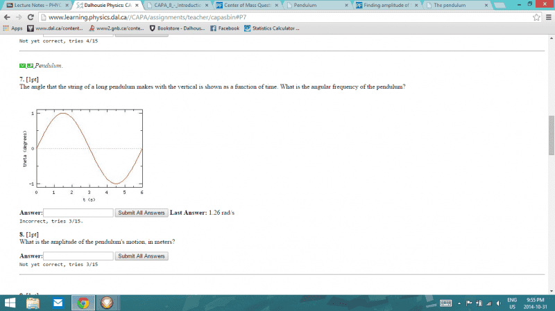

a)The angle that the string of a long pendulum makes with the vertical is shown as a function of time. What is the angular frequency of the pendulum?
b)What is the amplitude of the pendulum's motion, in meters?
Angular frequency=sqrt(g/L)
im trying to find the length of the pendulum from the graph provided but I am not sure how to do that..
By looking at the graph i think the period is 6 seconds,and the amplitude is 1deg.. but I am not sure how to proceed from here. Any advice would be helpful, Thanks!

Do you know the definition of angular frequency? Do you know how frequency is related to the period? Do you know how to manipulate the frequency expression you gave to solve for L?
Yes, Dr. D is correct up there. Think what the definition of angular frequency is Warning: angular frequency is a bit different from frequency in Hertz you get from graphs as the number of full wavelengths per second.
You already know the relationship between angular frequency and length of the string. (## \omega = \sqrt{\frac{g}{l}} ##)
Now you only have to determine angular frequency from the period that you determined from the graph. Good luck! ^^
