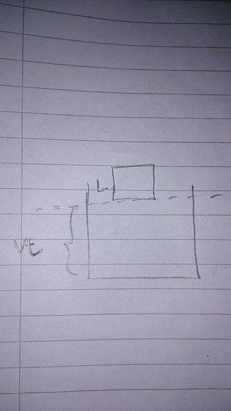

How do you get vt+L? Maybe it would help you to think about a more solid analogy. You are digging a tunnel. The excavator is a cube LxLxL. If it advances a distance vt, how much soil does it have to excavate? Draw a picture.
Still vt + L
sorry , the volume of the leading face of the box sweep through as the box advances that distance is (L^3) , what are you trying to say ?

If the leading face is LxL and advances distance vt, what shape does it 'carve out'? What are the dimensions of that shape?

Lay a light box, LxLxL, on soft snow. Press down on it, pushing it down a distance vt. Remove the box. What shape hole have you made in the snow? What is its volume?
volume = (L)(L)( L +vt) , shape = rectangular , is it correct ?
Nearly right. But we are only interested in the volume swept out by the leading face. That moves a distance vt, not L+vt.
so the volume = (L)(L)(vt) ?
