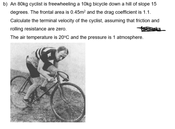

Hi All,
I am struggling with the question (attached) and was hoping to get some guidance and explanation on how to solve it.
I`m thinking that it is force down is equal to force up? But I could be wrong.
Any help greatly appreciated.
Regards,
James

I would definitely use a tilted coordinate system. Terminal velocity will occur when the forces down the slope are equal and opposite to the forces up the slope. What is your model for air resistance?

So would I be using Force = mass x velocity
Therefore F down = F up
Therefore mv = mv
I have no model for air resistance.
You are told that "the frontal area is 0.45 m^2 and the drag coefficient is 1.1". If that doesn't mean anything to you- in particular if you don't know what "drag coefficient" means- then you need to discuss this with your teacher.

Force definitely does not equal mass times velocity. You have $F=ma,$ and this holds up and down the slope, as well as normal to the slope (that is, in each direction of the tilted coordinate system). I would recommend you use the following attached Problem-Solving Strategy for this problem.
From a physics perspective, the key here is to recognize that at terminal velocity, which is constant, there can be no acceleration. That is, the acceleration must be zero.
As far as air resistance, you can model it as proportional to the speed, or proportional to the square of the speed. Look it up in your book to see which one your book is assuming.
