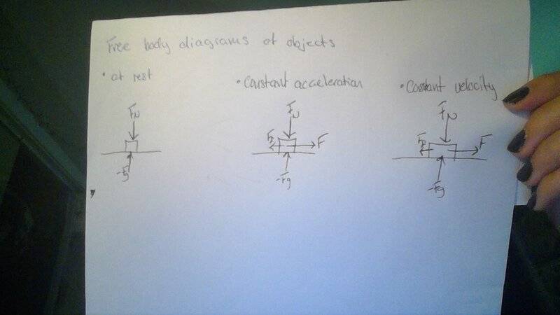

4) Both diagrams have proper force of gravity and normal force, as well as applied forces with no force of friction (will upload photo of my diagrams when I can but anything helps)
What my diagrams look like:
Constant velocity would be a straight line with no slope starting at some positive velocity, constant acceleration would be an increasing line starting at the origin with equal slopes

I just attached my version of the diagrams

Thank you for posting your free body diagrams (FBDs), but you did not really answer my question. Usually, when one draws a FBD there is a system that moves under the influence of one or more forces acting on it and the FBD is specifically drawn for that situation. Let me rephrase my question.
Does the statement of the problem as given to you specify what the system is and what its state of motion is? If "yes", then please tell us. If "no" there is a wide choice of FBDs to draw. Below are some possible examples, each having its own FBD.
  • A small block at rest on a flat horizontal tabletop.
  • A small block at rest on a flat tabletop inclined with respect to the horizontal.
  • A small block being pushed up an incline at constant speed.
  • A small block accelerating down flat tabletop inclined with respect to the horizontal under the influence of gravity only.
  • A small block being pushed up an incline at constant acceleration.
  • A small block accelerating down a curved slide.
  • etc., etc.
Do you see where this is going?

Thank you, that clarifies the task. The first posted FBD of the body at rest looks fine. The other two look the same when there should be a difference between them. What kind of difference? You may wish to redraw and repost to scale as best as you can.

In my mind, the reason the FBD of acceleration/velocity looks the same is because if I'm changing position at a constant rate and the change in velocity is constant, there should be a greater applied force than the force of friction.
Are you saying that, in both diagrams, the pulling force to the right must be greater than the force of friction to the left because the block is moving to the right?
yes
What does Newton's second law say?
I've been thinking about this since noon it's currently 9 PM. I think I got it now. Constant velocity/acceleration just means I'm putting the same amount of force to move the object to exactly cancel out friction while still moving it forward. At rest just means no force going against friction, and friction does not have a force going against it. Did I get it??????
