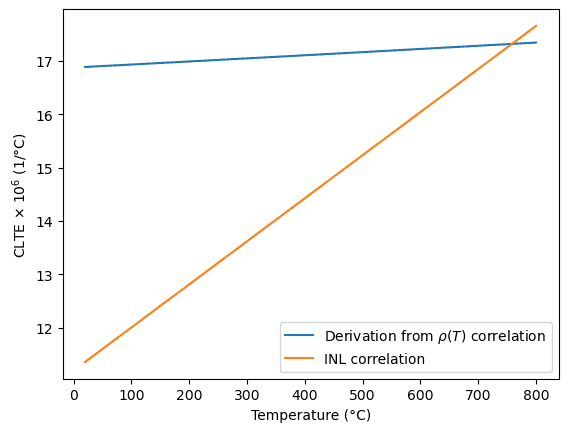

Hi all,
I am trying to derive a relation (as function of temperature) for the coefficient of linear thermal expansion (CLTE) strating from a correlation for the density. But I'm getting a huge discrepancy from the experimental data.
I'll start telling you some reasoning I did to get a relation for the CLTE:
Let's say that ##\alpha(T)## is the linear coefficient of thermal expansion. Than, the generic length in one dimension should vary as
$$L=L_0(1+\alpha(T)\times (T−T_0))$$
Let's now consider a cube of volume ##V_0=L_0^3##. Accordingly to the previous equation, and supposing a isotropic expansion, the new volume should be:
$$V=L^3=L_0^3(1+α(T)\times(T−T_0))^3=V_0(1+\alpha(T)\times (T−T_0))^3$$
Since mass is conserved, one can derive the density ratio ##\rho(T_0)/\rho(T)=V/V_0##. Therefore, if I'm not mistaken, the relation for the CLTE is straightforward:
$$\alpha(T)=\frac{(\rho(T_0)/\rho(T))^{1/3}−1}{T−T_0}$$

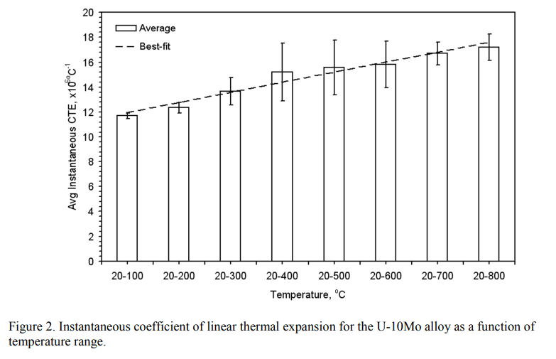

Now, I tried to apply this approach to the specific case of Uranium-Molybdenum metallic alloy. The paper from Idaho National Laboratory (Thermophysical Propertiesof U-10Mo Alloy D. E. BurkesG. S. MickumD. M. Wachs) provides a correlation for both the density and the CLTE. The problem is shown in the figure below: if i use the density correlation provided by INL (##\rho(T)=17.15+8.63\times 10^{−4}(T[°C]+20)##) and I derive the CLTE from it (blue line), it is different from their correlation (orange line) for CLTE (##\alpha(T)=11.2+8.07\times 10^{−3}T##)
I suspect I made some naive mistake in the derivation of CLTE correlation or I'm looking at two different definition of the CLTE. Any idea?
Do you know you are using a first order Taylor Series approximation of the solution for the ODE (1):
$$ \alpha(T) dT = \frac{dL}{L} \tag{Eq.1}$$

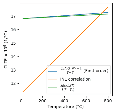

Thanks for your answer. You are right, it is a first order approximation, but I do not think that this is the problem: If so, the first order approximation and the INL correlation should at least agree at low ##\Delta T## but it is not the case. However, to be sure I can derive the real relation.
Let's start from your equation and integrate it in the range ##(T_0,T_1)##:
$$ \int_{L_0}^{L_{1}} \frac{dL}{L} = \int_{T_0}^{T_1} \alpha(T)dT $$
It becomes:
$$ ln\left (\frac{L_1}{L_0} \right) = \bar \alpha (T_1 - T_0) $$
Where ##\bar \alpha## is the average value in the aforementioned range. Let us multiply by 3 both side and exploit the logarithm rule: ##a ln(x) = ln(x^a)##. It follows:
$$ ln\left ( \left( \frac{L_1}{L_0} \right)^3 \right) = ln \left( \frac{V_1}{V_0}\right) = 3 \bar \alpha (T_1 - T_0) $$
Finally we can introduce the density ratio ## \rho_1/\rho_0 = V_0/V_1## and derive a relation for the average CLTE:
$$ \bar \alpha = \frac{ln(\rho_0/\rho_1)}{3(T_1-T_0)}$$
You can see from the figure that the first order relation and the complete one agree quite well at low temperature (as it should be). However, both are different from the INL correlation.
Any other idea?

##\bar \alpha## is function of the integration extremes ##T_1## and ##T_0##. While ##T_0## is usually taken as environmental temperature, ##T_1## can be arbitrary selected. The meaning of ##\bar \alpha## is the "average CLTE" in the range ##(T_0,T_1)##, its value varies if the extremes vary as well. In the graph i wrote T, while probably I should have wrote ##T_1##. If you look at the reference from INL, they printed the avg. CLTE as function of the extreme ##T_1## keeping constant ##T_0 = 20 °C##. I did in my graphs.

Yes, it was a typo in the post (btw, thanks @Lord Jestocost for pointing that out). However, I wrote it correctly in the python script:
Python:
import numpy as np
import matplotlib.pyplot as plt
#INL correlation for density
rho_umo = lambda T: 17.15 - 8.63e-4 * (T + 20)
#Theroetical derivation
clte_umo = lambda T: np.log(rho_umo(20)/rho_umo(T))/3/(T-20)*1e6
#INL correlation for CLTE
clte_umo_inl = lambda T: 11.2 + 8.07e-3*T
#PLOT
TT = np.linspace(20,800,1000)
plt.plot(TT,clte_umo(TT),label="my derivation")
plt.plot(TT,clte_umo_inl(TT),label = "INL correlation")
plt.ylabel("CLTE $\\times 10^6$ (1/°C)")
plt.xlabel("Temperature (°C)")
plt.legend()
