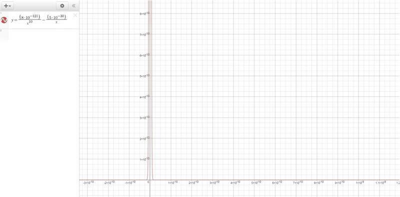

"see graph 1"
I also try to draw this graph on my graphic calculator but it gives me result similar to y= -1/x

  • Graphing calculator screenshot plotting y = (8·10^-121)/x^10 - (5·10^-30)/x, showing a nearly vertical spike near x = 0 and the curve almost flat across the visible range.

In your plot V(r) you also consider [itex]x\leq0[/itex], which is not correct, because distance r must be r>0. The coefficient of thermal (linear) expansion alpha relates the change in longitude L and the change in temperature T, [itex]\frac{\Delta L}{L}=\alpha \Delta T[/itex], in units K-1. So now you have an input for the variation of T...
