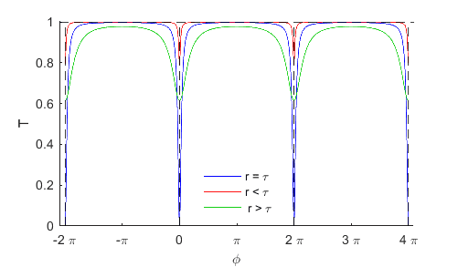

The shape of the curve depends on the values of r and tau. it is as "peaky " as shown when both parameters are close to 1, and it looks like a sine function if they are small. Usually, half-maximum is defined for peaks.

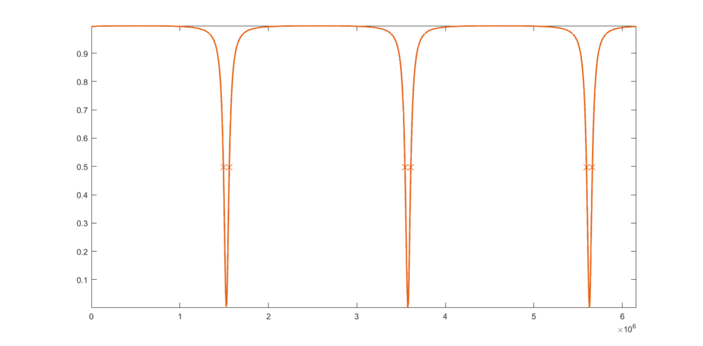

Hi Ehild,
Sure. Half-maximum is the point at which the function reduces to half its peak value. Here is a plot that I made where these points are shown with the red "x"s:
243617
I am trying to derive the analytic expression that gives the value of ##\varphi## at these points in terms of the constants ##\tau, r##.

But the T function does not look like that for any tau and r, and the maximum is not a peak, and the maximum is not 1, and the minimum is zero only when r=tau.
Yes, the shape of the carve is variable. I plotted a special case of T where ##\tau=r=0.95## so there is a complete extinction at the minimum.

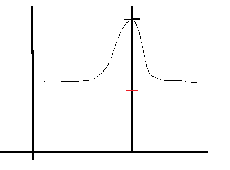

It is usual to speak about the width of a peak, the values of the independent variable where the function height falls to half of the maximum value. But the height is counted with respect to a base. In the following figure, for example, the function is completely above its half-maximum value.
243625
Likes roam
