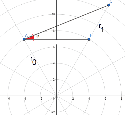

As personal curiosity, I want to calculate which is the difference in "travelled height" between a photon that goes across the width of an elevator - which is more or less 2[m] in my country - and a tiny mass particle that free-falls starting at the same "height" as the photon origin, and is released exactly at the same time that the photon is shot from the other side.
I'll make some assumptions in order to make this race "fair enough". Hope I don't make many mistakes and correct me if I'm wrong. We'll see...
First of all, thanks to the sponsors of this "tough" experiment: Coke© light (supplying the laser assembly) and Nanomass© dynamics for the test particle (which they sell by the weight and are dirty cheap).
Also, due the lack of budget, the test will be conducted in Earth, simplifying and considering the Schwarzschild metric solution to the Einstein Field Equations, so Earth and surrounding spacetime are not flat.

As for the setup of the test, if we shoot the photon with an initial non-zero launch angle ##\varphi## (inwards), then it will have obviously an initial inward geometric radial velocity, and being c a big number seems unfair to compare then the radial travelled distance of the photon with a poor test particle that starts quiet and still.
So, we'll shot the photon tangentially (##\varphi=0##). This means that if the path of light were unaffected by Gravity, would hit the other side of the elevator at a higher position (i.e., if the starting radius is r_0, would reach the other side at a radius r_1>r_0). In a nutshell, we don't point the laser towards the test particle, but a little above it.
For the test particle, it's starting position will be r_0, and so both the photon and the test particle begin at the same distance (radius) from the center of the planet.
That's fair enough for me.
With a simple Python code (attached), I obtain the following:
FINAL RESULT:
r1-rend=6.556e-16[m] r0-rend_m=2.185e-16[m] tend=6.671e-09
where r1 is the point-of-impact radius of a straight line with a length of 2[m] (we fix as condition the arc covered to be L/r_0), rend if the final radius of the photon position, rend_m is the final radius of the test particle position, and tend is the total flight time (in the coordinate time). So the radial distance displacement for the photon is 3.0004.. times greater than the radial distance displacement of the test particle.

I attach an extremely exaggerated figure, to better understand the scenario.
The laser is fixed at point A, at the left side of the elevator. The test particle is located at point B. Both laser origin and test particle are at the same radial coordinate r0.
For reasons given in the thread, the laser is pointed towards C.
At t0, the laser emits a light pulse and the test particle is released. At the time the front of the light pulse covers the arc between A-C (arc which is given as L/r0, being L the width of the elevator), I want the difference of r1 vs the radial coordinate of the light pulse, and the difference of r0 vs the radial coordinate of the test particle. For me, that is the distance radially travelled for each of them.
This awful lot of work is to test where the "uniform gravitational field" concept is applicable, if you can do the calculations up to n digits of precision.
Polar-grid diagram with origin at the centre and concentric circles marked 2, 4, 6, 8, 10 on both axes; points A and B lie on a horizontal line at radius r0 and point C lies farther out, joined to A by a line with angle phi marked at A, and labels r0 and r1 shown.

PeterDonis said:
...with both staying at the same "vertical" coordinate.
Don't know what this "vertical coordinate" is ¿?. I'm working with the Schwarzschild coordinates. The light pulse, moving from side to side will not maintain a constant radial coordinate, no matter what the "equivalence principle" says. Not even a mathematical straight line will do so, ...is what happens with polar or spherical coordinate systems.
PeterDonis said:
so the "fall distance" relative to the elevator is just the distance the elevator moves upward in the 6.6 nanonseconds...
I don't care the "fall distance" relative to the elevator, that's why the thread is titled "Einstein brother-in-law elevator"... the only think related to an elevator is the width scale of such a thing. Will not enter in discussions about rigid body movement in a non-uniform Gravitational field and so on.
And, of course, if the "Equivalence principle" applies in this case, the spacetime is flat, and why use the Schwarzschild metric? But I do use that metric, and I do obtain those results, being pretty careful as to maintain the required precision solving the equations of motion (that can be wrong, because are handcrafted).
If the difference is in the order of 10-16 m, of course that the number will show as zero with a casio calculator.

Lluis Olle said:
radial coordinate
Why would you even use radial coordinates in this problem? If your "radial coordinate" is measured from the center of the Earth, you are not testing anything related to what you say you're testing:
The Earth's gravitational field is already known not to be "uniform", so it's pointless to use radial coordinates centered on the Earth. You should be using Cartesian coordinates centered on the elevator itself.
Then you are not doing what you say you want to do; the "gravitational field" in Schwarzschild coordinates is not "uniform", and your entire analysis is pointless.
