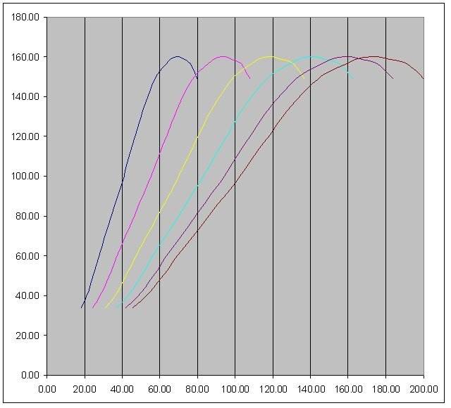

(My attempted solutions and understandings are attached as thumbnails)
Q.My question is on what rpm range do I base my power band(i.e the min and max rpms between which the gears change) [itex]\omega_1[/itex][itex]\omega_2[/itex]?

To get a smooth transition, power must be the same before and after shifting.
If you are looking for maximum performance, the ω1 & ω2 should be before and after maximum power (like in your drawing) such that the average power will be at its highest. The gear ratios will determine the width of your power band width (ω2 - ω1)

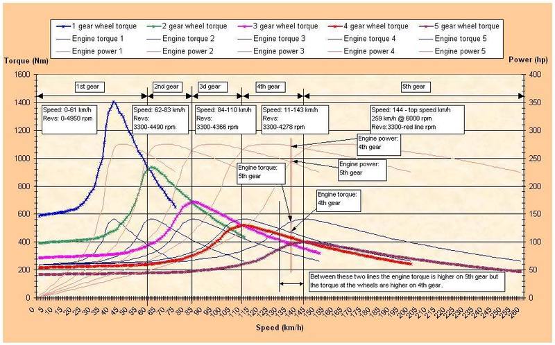

marellasunny said:
I'm guessing the below image is for gear shifts around max power.
That chart shows gear shifts that should occur when the driven wheel torque curves for each gear cross (which is why those curves are colored). These are the shift points for maximum acceleration, so they are done to provide maximum driven wheel torque while accelerating. The chart assumes that shifts are nearly instant. If the shift takes some amount of time, you shift a bit later so that speed lost during a shift is compensated for.
The chart has a mistake in one of the labels: "engine power 5th gear" is really "engine power 3rd gear".
