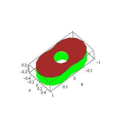

That looks like it might be about right. Here's a picture (I had a little time to waste):
Wow, thanks for wasting your time for me! ;-)
I guess the cam is pretty small so the volume is more reasonable than I thought.
