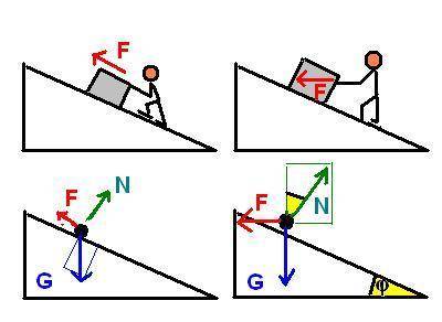

A block of weight 100N is slowly slid up on a smooth incline of inclination 37o by a person. Calculate the work done by the person in moving the block through a distance of 2m if the driving force is (a) parallel to the incline (b)in the horizontal direction.
I don't understand what should be the driving force? :confused:
Should it be 60N because the block is of weight 100N and its sine component is 60N?

Hi Pranav! :)
Yes, the work is 120 J, and the force the person would apply parallel to the incline is 60 N.
If the person applies a horizontal driving force, he needs to apply a different force.
Can you set up the equation for equilibrium?
Hello ILS! :)
When force is applied horizontally, the equation for equilibrium is:-
Fcos37o=60N
From here, i get F=100N. But then what should be the displacement? Should it be 1.2m?
Work = force in the direction of the displacement [itex]\times[/itex] displacement.
The displacement is still 2 m, the relevant part of the force is still 60 N. ;)

It is not explicitly said, but "the block is slowly slid up" indicates, that it does not accelerate and when it started from rest, its acceleration was so small that it does not count. No acceleration means zero resultant force.

The resultant force is zero, not the force used to move the object up the ramp i.e. the driving force. You don't find the displacement in the horizontal direction unless it is asked for, which it isn't, You use the force you found in part a, then find the total force you would have to exert if your force is horizontal rather than up the ramp. So force horizontal times cosine of the ramp angle will equal the force you already calculated needed to drive the mass up the ramp.
In other words, if you push horizontally rather than along the line of the ramp, you have to push harder to move the object up the ramp
When you calculated the 1.2m and multiplied it by the force horizontal, all you did was verfy that the work done is the same regardless of path, which is true but you aren't asked for the 1.2m so you didn't HAVE to find it to answer the question.

The resultant of the work of all forces is zero, and the sum of all forces too, but the work of the individual forces is not (except the normal force, its work is always zero). What I said was answer to your question about the driving force. It exactly balances the other forces, gravity and normal force. See picture: the red arrow is the "driving force", F, G is gravity (blue) and N is the normal force (green). When the applied force is parallel to the slope, its magnitude is Fp=Gsin(φ). If the applied force is horizontal, Fh=Gtan(φ). The work is displacement times force times the cosine of the enclosed angle. For the parallel force, the enclosed angle is zero: W=Fd=Gsin(φ)d. The horizontal force encloses φ angle with the slope, so its work is W=Fdcos(φ)=(Gtan(φ))dcos(φ)=Gsin(φ)d: they are equal (120J) and just opposite to the work of gravity -Gsin(φ)d.

F=60/cos(37)=75 N, not 100.

These questions can be done much easily if you draw the diagrams of the force acting on a block correctly. Your geometry should be correct and you must resolve the correct components of the force. In this straightforward question it is easily stated that first tell the force in the horizontal direction which is horizontal component of force. Using Pythagoras theorem you can then find the force parallel to the incline OR just divide your answer to previous part by cosθ. The slope of the two components can be determined by tanθ.
The drawings are critical for problems of this type. If they are done correctly you will almost always get them right.
