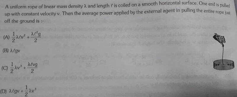

I came across this question in my textbook
Power=Work/Time=Force×Velocity
I tried to solve it by integrating force from 0 to L
dF=dm.g
where dm=λdx
And then I multiplied it with velocity to get power because velocity is constant
∫(vdF)=v ∫(dF)
But the book used integration to find work done and divided it by time for power
My answer was λlgv(Option B)
Giving (Option C) as answer
Where am I wrong?
Thanks for the help

Your first statement is
Aurelius120 said:
Homework Statement:: I came across this question in my textbook
Relevant Equations:: Power=Work/Time=Force×Velocity
To solve is a verb that, in most cases, means to isolate one particular quantity on the left side of an equals sign. What are you trying to solve? I don't know, and I rather doubt that you do , so I suggest that you start again and consider where you want to go.
Your dF expression only gives the force necessary to suspend an element length dx, statically. Multiplying by v then gives the power needed to raise that element steadily at speed v, but you have not considered the work done to get each element up to speed v from rest.
As against that, your integral assumes every element is lifted through height l.
Unfortunately, none of the options provided is strictly correct. The author has wrongly assumed conservation of work. If you don't assume that but instead consider momentum you arrive at ##\lambda v^3+\frac 12\lambda l v g##.
In practice, the answer will be somewhere between the two, its exact value depending on the mechanical properties of the rope. The reason it is not as much as given by the momentum analysis is connected with the chain fountain effect (q.v.).

I agree with the answer and method of book. It seems very natural to me to use the work energy theorem for this.
On the matter of why your method is wrong I agree with @haruspex.
But I disagree with @haruspex on why we shouldn't use the work energy theorem for this. He seems to imply that some power from the external force is lost as heat and not converted completely to kinetic energy of the rope, but I really can't see why we should view it that way.

Try using conservation of momentum, then try to explain the different result.
You could also try modelling what happens as the rope moves from rest. E.g. treat it as a sequence of chain links, each starting vertical. So each link moves up one link length before engaging the next. What happens then? If work is conserved, it will result in a vertical oscillation. That will swiftly decay, but not assist in raising the chain.

One need not integrate anything here. $$P_{ave}=\frac {\Delta (T+U)} {\Delta t}$$where ##\Delta T=\frac {\lambda l v^2} 2##, ##\Delta U= \lambda l g \frac l 2 ##, and ##\Delta t=\frac l v##. I think that does it.

The issue is what happens if, when the rope is entirely off the table, we stop pulling. Then the Kinetic Energy in the rope will be dissipated by the thrashing of the rope, and only the potential energy remain.
But that is not the question asked here and the correct answer is (C) as discussed.

I have seen equivalent problems posted several times over the last ten years on PF. Sometimes the official answer assumes work conservation, sometimes it uses momentum conservation (arriving at half the work being lost).
I used to take the momentum view, but have come to understand that the real behaviour will lie between the two, and where exactly in that range will depend on subtle details of the material involved. What exactly happens at "lift off"?
Depending on the model one uses, you can see how the elements may acquire horizontal or vertical oscillations that do not contribute to the overall upward motion. In the present case, the illustration has the rope starting in a coil laid flat, so at lift off the elements will acquire some horizontal motion. What becomes of that?
At the least, if you reject the momentum result then some explanation is required.

Yes. See post #3. If you consider each element of the rope being 'instantly' accelerated to v then momentum leads to ##\lambda v^3##, not ##\frac 12\lambda v^3##

As I wrote, the challenge in using work conservation is explaining what is invalid in the momentum conservation argument.

Faced with it prior to a few years back, I would unhesitatingly have used the momentum argument. Since then, I have become aware of the chain fountain effect, and a scenario in which a rope is at first suspended from two adjacent points, then one end released. (I believe there's a link to such a question from the link I put in post #15.). In the second case, experimental evidence is that most of the work is conserved and, in consequence, the free end falls faster than g!
However, as I noted above, I strongly suspect that the extent to which work is conserved depends on the physical attributes of the rope.
In the present case, with the rope in a coil lying on the ground, it is far from clear whether it will emulate the falling rope. In that latter case, it would seem that the rotational inertia as each segment turns around the bend to join the hanging section acts to pull down the next segment. It is not apparent to me how something similar will happen with the lying coil.

In time dt a further mass ##\rho vdt## is lifted from the ground. That means it goes from rest to speed v, so the impulse is ##Fdt=\rho v^2dt##. Power ##=Fv=\rho v^3##.
As I have remarked, I believe both conservation law approaches have flaws, and the truth will lie somewhere between the two, but where may well depend on details of the configuration and the material properties.

The rope between what's immediately being lifted and the top is moving at constant speed, so the applied force exceeds the F in my post by the weight of the suspended length of rope.
So the correct equation is ##F(t)dt-\rho x(t) gdt=\rho v^2dt##?
Yes.
haruspex said:
Yes.
Ok I see and then we arrive at the answer you post at #2, which differs by a factor 1/2 on the first term from the book answer. Well, it beats me, according to your opinion why it differs? OK I know that conservation of energy does not hold always but why using the momentum approach we still don't get the right answer cause as you say the right answer will be something in between?
