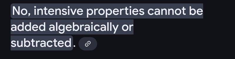

The answer given is 524*10^4. The process used is by adding/subtracting the values given. But my concern is that isn't molar conductivity an intensive property? And it hence can't be added. So how is it added and the answer obtained.
Who says intensive properties can't be added? How is the total pressure of a gas mixture related to the partial pressures of its components?

Partial pressure times the mole fraction is added to get total pressure. Not partial pressure separately. Intensive properties can't directly algebraically be added so why is it here?
Not so. If the partial pressure of oxygen is 0.2 bar, and the partial pressure of nitrogen is 0.8 bar, the total pressure is 1 bar.
You are perhaps thinking of Pi = xiPtot
But Ptot = P1 + P2
= x1Ptot + x2Ptot
But Ptot ≠ x1P1 + x2P2
Oh you're right but why does my textbook and even google say that intensive properties (like electrode potential) can't be algebraically added or subtracted
Without a context, I can't say.
Looks a bit like answer from ChatGPT: definitive, authoritative, polite - and incorrect :wink:
So
Do you mean intensive properties can be added? If yes, what are the conditions?
From the quick googling you are not the first to ask that question and the discussion is not new, problem is with the division extensive/intensive which is not as good and clear as it sounds to be. Compare Redlich, "Intensive and Extensive Properties" J. Chem. Educ., 1970, 47 (2), 154–156 (can be found as a downloadable pdf).
