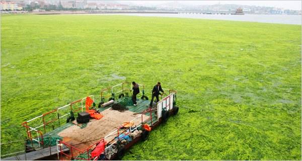

Qingtao china overproduction algae beaches

http://www.nytimes.com/2008/07/01/world/asia/01algae.html
