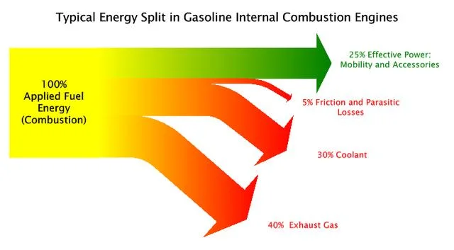

Smokey Yunick had the solution in 1984 with his Hot Vapor Cycle engine. By capturing and reusing heat normally dissipated, efficiency dramatically improves.OmCheeto said:This thread is more and more reminding me of my very first thread, and the image that inspired it:
The image confused the hell out of me.
In his Pontiac 2.5 liter engine, he reduced the radiator size by 50% then applied the remaining heat energy via coolant to a heat exchanger surrounding and beneath the throttle body and single fuel injector, raising the air fuel mixture to 90-100 degrees C.
Air Fuel mixture then enters a homogenizer - basically a turbocharger. The homogenizer has a double wall where a controlled amount of hot exhaust acts to further heat the fuel air mixture to around 150 degrees C with simultaneous blending by the impeller.
Then the mixture enters the intake plenum and runners which are surrounded by another exhaust heat jacket bringing the mixture up to over 200 degrees C and past the heat of vaporization of gasoline. The turbocharger ran a low boost pressure, acting as a one way check valve while the mixture is heating and expanding.
Smokey made the observation that gasoline is a complex blend of compounds with different densities and heats of vaporization. Optimum combustion occurs with a unified homogeneous mixture. He noted much smoother engine running, more power and improved efficiency, netting 51 mpg and 250hp in the Fiero. He ran stoichiometric air fuel ratios of 14.7 to 1, but there are also accounts of his tinkering with leaner mixtures. The engine passed emissions regulations in effect in 1985. Likely issues were with Nitrogen Oxide emissions. This could be resolved now with electronic controls and reduction catalysts commonly used with diesel engines.
