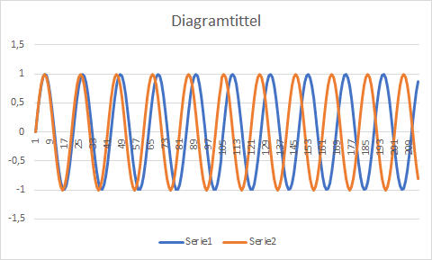

jaumzaum said:
I was wondering if a periodic function could have 2 different fundamental periods? If so, could you give an example? And If not, how can I prove that?
Do you mean something like that (red curve)?
It is the sum of two sines that results in a curve that could be described as a curve with two fundamental periods. In this case, the sines which are taken to produce rectangular signals:

What about periodic functions where the ratio between the periods is irrational - such as sin(3x) and sin(πx)?
What about them? That's two separate functions each with a well defined period.
Did you mean f(x) = sin(3x)⋅sin(πx) or g(x) = sin(3x) + sin(πx)? Those are not periodic.
