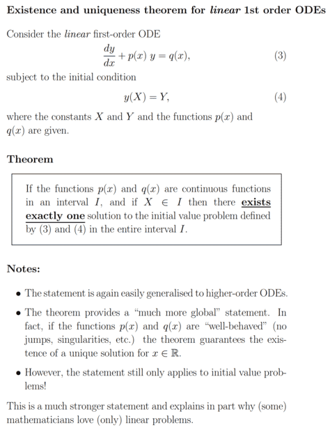

Thanks, is there a proof that it is the only solution anywhere?
Also, is it the same problem as the one I said in #109? Is e^+-ikx the only plane-wave solution for the wave equation?
May I ask the level of your knowledge about differential equations and their solutions? In post #114 I stated that the solution ##\exp\left(-i\left(E/\hbar\right)t\right)\Psi_{0}## to the time-dependent Schrödinger equation for constant E is unique. I know this because mathematicians long ago proved the existence and uniqueness of solutions to linear ODE initial-value problems. For example, see this page from the lecture notes at https://personalpages.manchester.ac...tYearODEs/Material/ExistenceAndUniqueness.pdf:
The substitutions:$$t\rightarrow x,\:\left|\Psi\left(t\right)\right\rangle \rightarrow y\left(x\right),\:i\frac{E}{\hbar}\rightarrow p\left(x\right),\:q\left(x\right)\rightarrow0$$along with the initial-value statement:$$\left|\Psi\left(0\right)\right\rangle =\Psi_{0}\rightarrow y\left(0\right)=\Psi_{0}$$ maps the Schrödinger equation precisely into the form of eqs.(3),(4), so the theorem applies and the unique solution is the exponential one found in post #114. And same is true for your plane-wave solution to the 2nd-order ODE it satisfies. The solutions must be exponentials and only exponentials. It's proven mathematics!

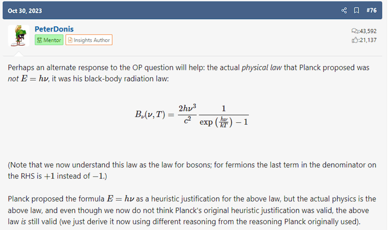

Thank you so much! Your post was insightful. (At least if Schrödinger equation was derived without supposing the premise you arrive at using it for a state of constant energy. If not it would be underwhelming.)
But then, what really means an "state of constant energy"? Is that a photon?
Also, the reasoning we use now to derive E=h*f as @PeterDonis told me in another thread (see screenshot) is that one you showed me @renormalize ?

Does anyone know what is the other derivation "using different reasoning from the reasoning Placnk originally used" that he mentions on that screenshot?
