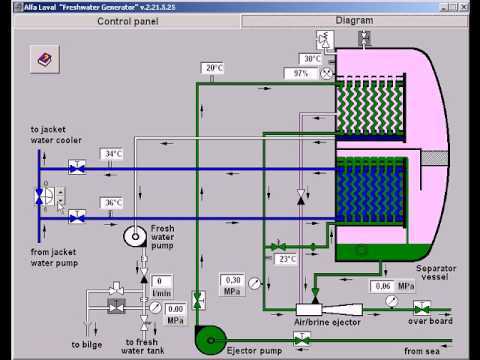

I'm not an expert as berkeman said lol but i do work on such systems on a daily basis.
Standard plants are maintained at 90% vacuum for a reason. It keeps the boiling point at around 50°C.
Do you know why? Its because at greater vacuum the water will flash almost instantaneously and salt particles will go up along with the vapour and demisters can't stop this.
Salinity of distillate will keep on increasing.
Also the feed can be heated more to facilitate production but the higher temp. Cause hard scales.

Look man I'll tell you as simply as I can.
Forget the heat source. For you to get pure ice you need pure water vapour. You CAN get pure water vapour from sea water but it will be miniscule. So you increase the rate of evaporation by increasing the vacuum, at the cost of purity.
I've detailed the rest already. To get 20tons of fresh water of salinity around 20ppm per day you need total flow maybe 500 tons. Who know? I havnt calculated.
Tell me in detail your plan and I'll tell you the stumbling blocks.
i suggest you download and read let's say the alfa laval fresh water generator manual.
good luck.

As you have probably read in the wiki you need several freezing and thawing cycles for it to be drinkable.
1)You will need the machine to work continously not in batches.
2) At such a great vacuum a huge amount of salt will contaminate the vapour i.e. unusable.
3) The remaining sea water in the column is brine i.e. conc. seawater
4) your method will produce large amounts of salty fresh water, lesser salinity than sea water but not by much.
5) your system is exactly like current systems with only the vacuum increased.
6) LET IT GO...or study engineering then let it go.
