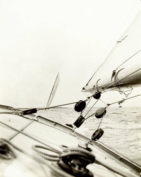

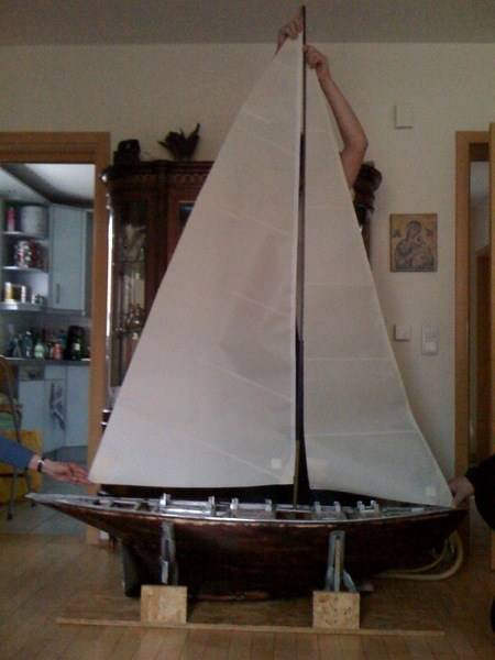

Dear friends, I am a naval modelist and as i am retired due to health problems I use my project ob building a sail boat model as a red line to learn about the diverse technologies I am confronted on this path. So my goal is not that of finishing the project of my sail boat, but to learn ans study and practice the topics i am meeting on this path. here a pretty old foto I made of my model to gat a sense about how it will look like:
Now the opening of the sail, means the rotation of the boom to which the sail is connected to on the bottom side, this boom is capable to rotate around the Z-Axis, the vertical axis.
Now it is my goal to implement in my model the same kind of pulley as can be seen from a sail boat, the Endeavour, called J-Class from the beginning of last century. This boat had a hull length of about 35 to 40 yards!
Now serious "experts" in building model sailboats wrote to me that due to the friction in the sheaves of the blocks in a model that is 1:20 times smaller, will not be operable. None of the methods existing this day allow to support a displacement of the sheet by 8400 mm in my model, this is the name for the rope that goes through the pulley and limits how much the sail can open, means rotating the boom about the vertical Z axis by increasing the angle between the boom and the hull center line!

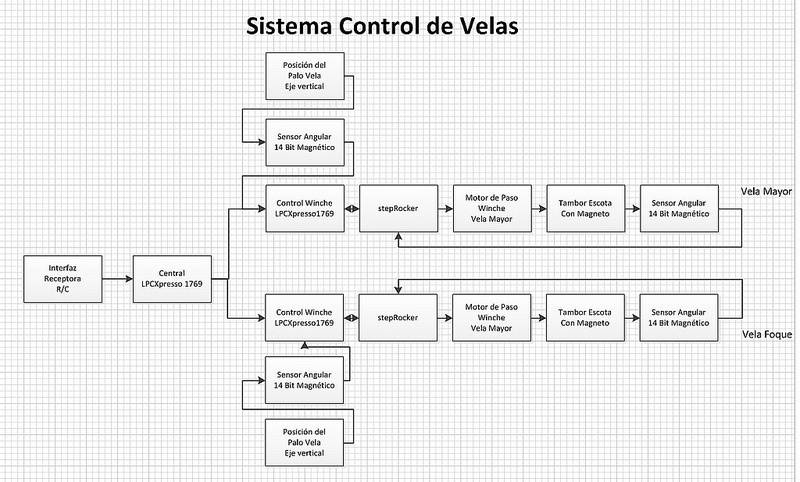

I have deviced a so called "sheet control system", pretty complex, here a block diagram I developed to be able to talk about my systems concept:
I also have other objectives, like the one to get the most energy efficient implementation of the system. Now as you all are aware of it is best to start modelling a relatively simple part of my system. So I decided to model the pulley as seen on the photo from the original sailboat!

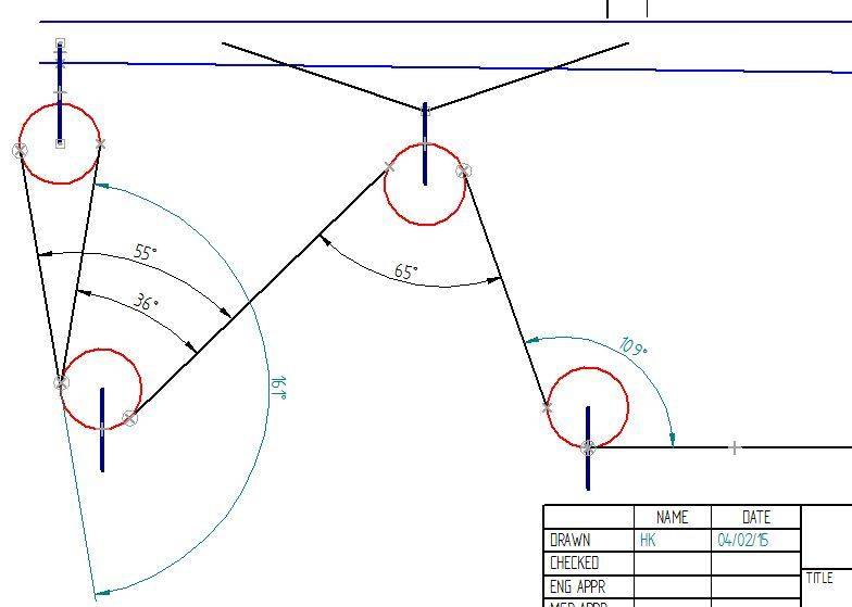

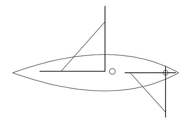

So I did start by drawing the discs that make up the pulley on the photo! let's start from the bottom right:
The sheet comes over the deck from the from part of the boat, where it goes under deck to the drum that is part of the winch. For this first part of the modeling effort I simply assume the winch will make sure sheet length is made available without a tension coming over the sheet is required.
The sheet passes through the pulley on the deck and goes up to the first pulley connected to the boom of the sail. from here it goes to the block that contains 2 discs and from it to the rear disc connected to the boom and back to the second disc of the rear block on the deck. From their it gets to a second disc connected to the boom is invisible behind the one on the drawing and then back to another disc that is equally invisible and located on an opposite side of the deck. The the sheet goes back to the from of the boat and under deck, where it is fixed connected to the hulls hardware! So this end of the sheet is fixed!
This drawing shows how the friction between a pulley and the rope depends on the tension to which the rope is exposed, here the tension is coming from the wind blowing into the sail and passing this pressure to the sheet over the 3 pulleys connected to the boom! But also on the size of the angle it is embracing the pulley. her the link to wikipedia regarding the Euler-Eytelwein equation!

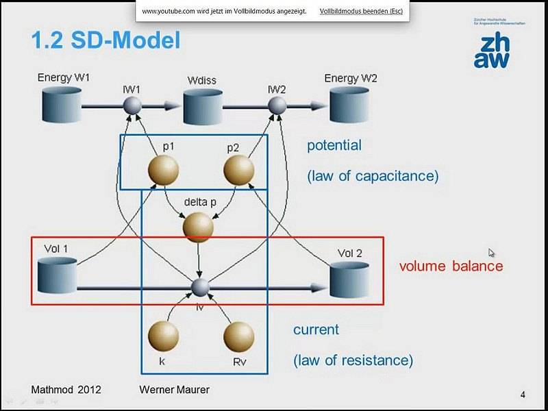

Werner Maurer somewhere defines System Physics as a methodology to address physics from the perspective of the modern complex dynamics system approach by using those tools to model the subject he teaches in his course and have his students apply the tools of the complex dynamic systems arena, like Berkeley Madonna for example, to model a work assignment. This way his students can verify what they are learning in the physics course by applying it to the modeling tool, simulate the model and verify that the results from the simulation correctly reflect what they have just learned. This way students not only learn how to apply mathematical formulas to solve assignments, but to verify that by the models they generate their understanding is really correct and how to apply it! The above flow chart, made using Berkeley Madonna shows the basic elements when applying modern methods from the science of complex dynamic systems. The basic structure consists of recipients and flows that add to the content of a recipient of that take substance from the recipient. You can see the full analogy the the fluids dynamics as mentioned in a thread here in the forum about 2 water tanks!
SD stands for "system dynamics". So taking the analogy from the fluids in the 2 tanks thread in this form, water is flowing from tank 1 to tank 2, here Vol 1 and Vol 2, marked with a red box.

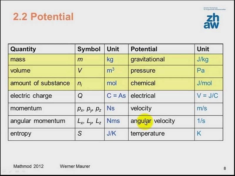

To explain the "law of resistance" and "law of capacitance" I like to use a table that shows for the different kind of areas in physics what those term mean. I get this from material in english language available at this site:
Here you can see what magnitudes, titled "Quantity" in the table reflect the different areas of physics as teached in a bachelor course of physics, the related symbol and the units. The Potential reflects the nature of the second element. So i.e. mass in combination with the Earth gravity field leads to the weight or potential energy. Mass in combination with velocity leads to Momentum. Equivalently for each of the seven kind of quantities there is an associated potential. Just as a side comment. The same equations, relations are found in the different areas of physics, uncovering by this perspective a common property across apparently completely different fields in physics!

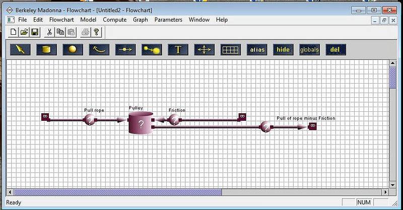

Now I want to present you with my first trial to model a pulley llnked to the image of the pulley and the forces on it!
All I did in this image was to draw for every disc in the pulley a recipient and for the rope through that pulley arrows reflecting the rope! As you can see by the question marks on the violet colored globes, those are still empty. In here I will have to place the equations. What is till missing completely are those brownish globes and the curved lines that you can see on the flow chart above. Those brownish globes are used to contain the formula that reflects the relation and the source from which a parameter of the equations in the violet globe on the flow arrows gets its value from! So this way, until not all the question marks on the violet globes disappear, there are still undefined parameters in the equations they contain.
This I consider a wonderful way to handle a complex system design! The graphics feedback in the flow chart not only makes it easy to keep adding dependencies, but it also helps to keep track of eventually uncomplete definitions of parameters in equations!
Now I have said that each recipient in this flow chart represents one of the 7 drums of the pulley and each of this recipients stands for the model of each individual drum!
This flow chart is my first trial to generate a model of an individual drum by reflecting the red colored forces on the graphic of a pulley i have made available above and on which the Euler-Eytelwein equations are based.
Now finally my problem and question:
If the Pulley recipient in the last image represents a physical disc, then its content is "Momentum". The flows into that recipent is the pull tension coming from the sail over the sheet, a force: Fine.
The other arrow pointing into the recipient is the friction, I guess and whose direction is opposite to the pull force from the sail! What I am searching for is the balance, were the force coming into the recipient from the pull of the sail is equal to the friction. or better expressed the sum of this 2 forces equals "0". If a pulling force on the sheet is the result from wind blowing into the sail, then this equality would reflect the wind speed at which the force the sail pulling the sheet equals the friction in the pulley. any wind faster then this one would be able to overcome the friction is the pulley!
But at this condition the "velocity" = "0" and as a consequence the content of momentum in the recipient equal "0". So the balance only happens, when the momentum content of the recipient is empty!
But what value has to be taken for the mass? The rope is considered to be free of mass!
May be this "fluid image" often used in system physics as a visual mean to reflect physical situation, as the same principle apply to any of the 7 quantities listed above!
The image shows in detail a recipient and uses it, as I do need to do it, to represent a mechanical system! The mass represent the cross cut area of the recipient, the velocity the filling level are fluid level in the recipient. You can also see that in system physics, here translational mechanics the reference Momentum is given by earth! In my thinking right now when my pulley is in balance the recipient filling level is equal to the surrounding Earth level! Still so, what would be the mass in my case?

First, your post is way too long and way too complex to understand it clearly.
From what I understood, you are using the wrong model. If you assume you have no mass in the system, then your model shouldn't have mass involved. The Wkin is the kinetic energy (= ½pv = ½mv²), which you cannot have since it is massless. What you will have is friction, which will translate into heat (= friction force X displacement). That is where you will have an energy loss.
If there is no motion (v= 0), then a model based on kinetic energy is not useful either. In static version, the disc (or more probably the rope) will compress under the normal force; That could be modeled into a spring for which the energy stored is ½kx².
Although, I'm not entirely sure of what you are trying to do, it seems to be more complicated than it needs to be.

If there's no mass and velocity, you cannot call it a dynamic model.
The fact is that in your model there is a mass (it's the boom of the sail). You just assume that the mass of the rope is such a little mass that it will have negligible effect compare to the boom. One of your «discs» should have that model implemented. All the others will be connected to it and the mass of the boom will have repercussion on them.
Although I'm not particularly familiar with Modelica, the modeling you are trying to do is purely based on mathematical expressions where there are x equations with x unknowns. But you still need to use the appropriate equations that represents adequately the physics behind every system component.
If you use such a model with dynamics in mind, you either will have to input a force or a velocity function at the sail and your program will give you the response your looking for (which I'm not sure what it is).
If you are looking for a simple static equilibrium, such a program will be kind of useless as simple free body diagrams will give you the only possible answer you can get (still a system with x equations and x unknowns, but no derivative or integral involved).

The original J-boat pulleys likely had only sleeve bearings, but your detailed drawing shows what looks like a ball bearing. What do you actually want to model?
You use the phrase "red line" in a strange way. This usually means a limit to some sort of behavior. "Don't cross the red line, or I will shoot at you," sort of thing. You seem to be using this phrase to mean something more like "a learning vehicle," or something similar. Perhaps you might want to consider your terminology here.
Your project seems to be exceedingly ambitious in that you have set yourself a physical problem, but then you have also set limits on how you will allow it to be solved, all the while admitting that you don't really understand the physics of the whole system. This seems to be unduly limiting if your have any interest at all in your original objective of learning how the system works.
Your focus on "system physics" seems to have obscured your vision as to what is really important in terms of the pulley friction. The Euler friction equation you mention will describe the friction between the rope and the pulley roller. It is usually safe to assume that there is no slipping at that interface, but the friction you need to worry about, the one that will cause your system to bind up and fail, is the friction between the roller and the axle. Whether it is a simple sleeve bearing or a rolling element bearing as shown in your detail drawing, this is what will make or break your system. The Euler friction model is not relevant here. To model this friction properly, we need to know whether you are talking about a sleeve or a rolling element.
Looking at the forest, it seems you might not have seen a tree!

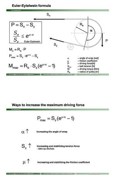

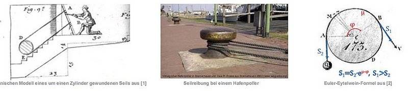

This picture shows visually the elements used with the Euler-Eytelwein-Formula! if you read my previous post you can see that the friction in the axis is minor, only between 0.03 to 0.05 percent of the total friction. I plan to use ball-bearings! key to the friction is the angle "beta" expressing the angle with which the rope embraces the sheave! No slipping is assumed in the Euler-Eytelwein-Formula, as you can see there is no differentiation of the friction between a slipping condition and a none slipping condition!
This image gives you indications of how the friction effect of a rope around a cylindrical object has been recognized since centuries and is used until today!

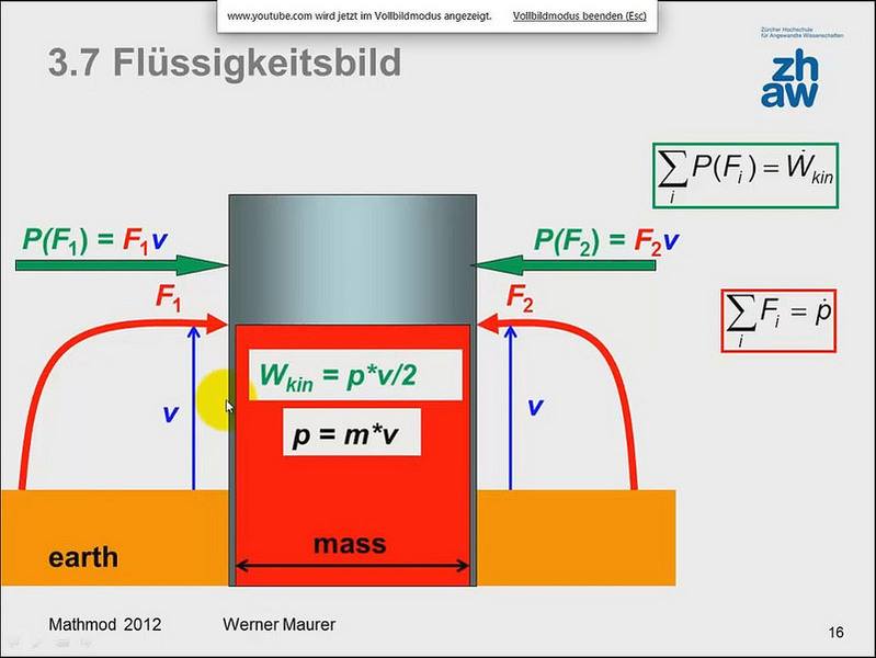

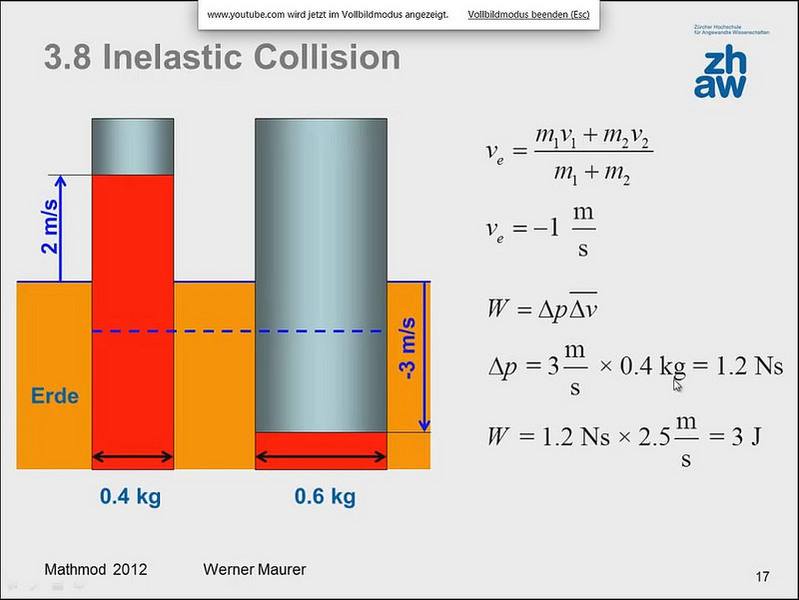

Allow me to close this answer technically by presenting what is called a fluids image of a mechanical concept and in which I am guessing right now is hidden for me yet the solution to my lack of knowledge:
As you can see in this picture is the momentum of a mechanical system contained in the recipient. The recipients geometry and that of its content reflects the equation for the momentum:
p = m * v
and that of the kinetic energy:
Wkin = P * v/2
But what is key to note is that velocity vector shown in blue starts from the environmental level given by earth! So the content with a velocity of "0" would just mean that the momentum content of the recipient has the same level as the environment earth! The force filling momentum into the recipient is called in system physics terms also a momentum pump, as it extracts momentum from the infinite resource Earth into the recipient. same applies to the kinetics energy! Kinetics energy in this model is "0" when the volume of the recipient is at the same level as the environment.

Helmutt, look again please at your friction problem, using your image.
The Euler friction equation describes the friction developed between the rope and the rotating pulley. It does not describe the axle friction. In your case, the tension difference is due to two effects: (1) inertia of the pulley, and (2) axle friction. With ball bearings, the axle friction will be small and the pulley inertia possibly a more significant term, depending on the acceleration of the rope.
Look at the center picture below. It is clear here that the force difference generates a torque that is transferred directly to the ground. That is NOT your case.
proxy.php?image=https%3A%2F%2Ffarm9.staticflickr.com%2F8715%2F16702253247_74ac58e2ae_c.jpg
This is a continuation of my previous response; I was interrupted for a few minutes.
If you will draw a proper free body diagram of the pulley and the rope segment in contact with it, the external forces acting on that FBD will include:
1) Rope force to the left;
2) Rope force to the right;
3) Distributed tangential force on the inner surface of the pulley (axle friction force);
4) Radial force from the axle.
The first three of these produce torques about the axle (the 4th produces no torque because it acts through the axle center line).
What this shows is that the distributed force between the rope and the pulley does not enter into the motion of this system; it is an internal force pair (a pair because it acts on the pulley in one direction and on the rope in the opposite direction). It is this irrelevant internal pair that is described by the Euler equation.
What you need is an expression for rolling element ball bearing axle friction. For this, I would refer you to Rolling Bearing Analysis by Harris (1965), p. 446.

Sorry to contradict you! here a link to an article about the Euler-Eytelwein-Formula, in english also called the "Capstan Equation"!
I am showing the second paragraph in the page to which I deliver the linK.
Because of the interaction of frictional forces and tension, the tension on a line wrapped around a capstan may be different on either side of the capstan. A small holding force exerted on one side can carry a much larger loading force on the other side; this is the principle by which a capstan-type device operates.
Specially that part that says that a "small holding force exerted on one side can carry a much larger loading force on the other side!
with:
being the angle the rope embraces the sheave in radian
being the static friction coefficient
Fh being the pulling holding force and
Fz being the force from the load!
Unfortunately i did not find an equivalent wikipedia site in english to the german version I am using! But in this article it is written that the holding force required to hold a load decreases fast with the increase of the angle with which the rope embraces the cylindric body! it gives as an example a steel cylindrical body were an embracing angle of 360° of a steel rope already reduces the holding force to just 40% of the load! from the same source I have the data that the impact of the bearing of the sheave is just 3% in case of a ball bearing and can increase to 5%. In this context the axle friction is closed to negligible and using a 3% value will be at least initially acceptable!
As I mentioned, it is a mistake that is not encountered with people familiar with naval ships or naval models, but often with people not familiar with this topic! Here a link to a PDF archive that is even more explicit!
This copy of the first page of the pdf archive I have supplied the link to is more then adequate to not only illustrate the impact of the friction in the individual sheaves of the pulley I plan to model. The archive goes on and even presents a simple pulley with 2 sheaves!
What I am still in doubt with is a comment that the diameter of the cylindrical object, in my case the sheave is not relevant! Here the equation I have found at the german version of the wikipedia about the Euler-Eytelwein is more accurate. from practical experience it is well known that if the diameter of a sheave is too small then the rope will not make the sheave turn and so it will not work as an element of the pulley!
But back to basics. I want to know how to apply Euler-Eytelwein in the context of the System Physics!

Let me clear up one point for you. The Euler friction equation is not news to most folks at PF. I first encountered it as a college freshman 58 years ago, and I've used it off and on, as needed, through the years. I try to avoid using it where it is irrelevant.
This is not so very foreign that your elaborate explanations are required. In my own case, I am an accomplished sailor, and I did my doctoral work many years ago on the hull design for heavy displacement sail boat like a J-boat. I do understand how the boom sheet system works, so no need to lecture on that point.
If you look at the information you gave, it is for a CAPSTAN, but that is not the same thing as a PULLEY.

Even though the Capstan equation can give a value for the friction force, this can only be a maximum force. The true force will be one that can be resisted. In your case the torque produced by the friction force of the rope will be equal to the torque of the rolling resistance of the bearing.
To better imagine the phenomena, you can take for example trying to push your hand across a fixed piece of wood: You will feel a certain resistance due to friction. Now put the piece of wood on a slab of ice and the resistance will be a lot less. Why? Because now the piece of wood slides on the ice before the friction force between your hand and the piece of wood can increase to its maximum value. Your hand will not move with respect to the piece of wood and the force will be equal to the friction force between the piece of wood and the ice.
That was the point that @OldEngr63 was trying to make.
I do understand what system physics is all about as one of my teacher in my university has developed a similar theory and it was part of my mechanical engineering program. He was an electrical engineer and I always felt it was more a tool for an electrical engineer to relate problems from other fields to equations and concepts he understands better. I, on the opposite, tend to model electrical devices as mechanical devices to better see them. This is probably why I never really used this theory since then (over 15 years ago).
The point is, you should understand the relevant equations before «translating» them into system physics. Do a free body diagram for every component and develop the equations for them ([itex]\sum F = ma[/itex]; [itex]\sum T = I\alpha[/itex]) for every axis (x, y, z). I think this will help you a lot in your quest (It certainly won't hurt).
Hi Hellmut
Of course there is nothing "paradoxical" about size of pulley being irrelevant. The Euler-Eytelwein relates the maximum difference in tension that can be obtained on either side of the pulley, or cylindrical object, due to the amount of wrap, by using only the angle of contact of the rope with the object. Big pulley, small pulley - using the same coefficient of friction between the rope and pulley, the ratio of Sn to Sz will always be the same. Of course, the absolute values of Sn and Sz will be different.
The size of the cylindrical object comes into play in several instances. The number of wraps needed for a winch, the holding force around a non-rotating cylindrical object to balance a much larger force. For no slip, a lessor number of wraps is needed for a larger radius. And the friction through a jammed pulley.
Which brings us to the equation you have seem to have overlooked. Namely the moment equation.
Mn = Rb P
Rb is the radius of the cylindrical object.
The moment might be supplied by a motor for a winch or capstan, or even a hand turning a lever. For tying up the rope to a pier to dock your boat, the moment is supplied by the torsion of the pillar and the earth.
For the pulley, for nice rotation, one wants the moment supplied by the bearing to be much much less than that due to the Capstan equation. If the bearing moment is greater than, the pulley will not rotate and either there will be undesirable rope slippage, jamming.
In other words, one wants the tension on both sides of the pulley to be as close in value as possible, and NOT near anywheres close to that given by the capstan equation.
Fine, experiments verifying the results will tell what is the truth! Still so, as I have the firm intention to model my sheet control system using the language Modelica. I want to be able to model the sheaves and the pulley as part of this sheet control system! As good practice when modeling is always comparing the result from simulation using a model and the results from experiments. This is why I am pursuing in parallel to have the model environment to get data from real hardware and verify the results. Its called hardware-in-the-loop and software-in-the loop!
Additionally as a resource to investigate I do have the master thesis about the friction between a rope and a sheave and in different kind of nautical nodes. So my suggestion is to let the discussion of the applicability of the Euler-eytelwein-Formula out. Just have to see how to model the sheave and combining 7 instances of the sheave to model the pulley using in a first step the scheme from System Physics and then to pass this to Modelica. Thanks.
OP,
In post #1, you show a picture of a sailboat's mainsheet system. There are several blocks, arranged to give a 4:1 mechanical advantage.
In post #9 you show a picture of a bollard, and speak of the capstan equation. Yes, the capstan equation models bollards.
A block is far from a capstan, and the capstan equation should not be used to model blocks. An ideal capstan does not rotate. An ideal block rotates with zero friction.

The 2 sheaves in the drawing on the right side are actually each 2, one on each side of the deck and on the boom. The block to the right on the deck has 2 sheaves!
This very simplified drawing shows the 2 orthogonal extreme positions the boom of a sail can take and does so by showing that I plan to have the main and the foque sail to have a boom. Now the angles the blocks and the rope through the seven sheaves of the pulley have, differ if the boom is above the center line of the hull or if it is in a 90° position. The greater the angle between the centerline and the boom is the more the rope will display friction with the side walls of the blocks! Also the angles with which the rope embraces the sheaves will vary a lot!

This drawing allows me to present to you my dear readers, as poor and as of limited use the drawing is, what parameters are available for me to "play" with! Allow me to expand on this!
The boom of the main sail in my sailboat model has a length of 1 meter. So where along the rear end of the boom I do place the blocks containing the sheaves shown in this drawing has an effect on the angle with which the rope embraces the sheaves! You can imagine, the more I move the bottom right 2 sheaves to the right the smaller will be the angle with which the rope embraces this 2 sheaves, one on each side of the deck of the sailboat!
Similarly, also the placement of the other sheaves impacts the angle with which the rope embraces the sheaves and, as assumed the friction generated, not by the bearings, but between the rope and the cylindric surface within the sheaves! Of interest will also be to understand the impact of the length of the ropes from which the 2 heaves on the right side are connected to the boom! The pulling force on the rope within the pulley is the result of the forces from the boom to the 3 sheaves that are connected to the boom and also to the ones connected to the deck! This means that the pulling force resulting from the wind blowing into and around the sail are fed into the pulley at different locations!

I am including in this response a block diagram of the whole "sheet control system" of which the pulley is just a small part that I have selected to use it to learn about modeling and simulation and applying "System Physics" and the modeling language Modelica. I am doing this not only to accomplish my objectives, but also because learning this methods is fun! I use my project of building my sailboat model as a line of action were on its path I meet the most diverse technologies into which I can dwelf!
Just simply spokeN: My sheet control system has the task to control the position of the sail by making the proper length of rope available. For this I use an magnetic angular encoder that gives me for the 90° angle to each side of the hull 512 angular positions. For each angular position there is a table that links it to a specific position of the stepper motor that turns the drum with the rope! The stepper motor has to make 21 full 360° turns to change the length of the rope from its shortest to its longest range. For each 360° turn the stepper motor makes 200 full steps and for each one of those 200 full steps the stepper motor makes 256 microsteps. So the stepper motor has over 1 million different positions that result in different length of the rope.
The result of this is, that for any given and monitored angular position of the boom of a sail the stepper motor will only make available the required length of the rope. This way I have a tight control of the length of the rope!
The position of the control stick of the R/C transmitter of the skipper is digitized using the PWM signal coming out of the associated channel on the R/C receiver and represents the maximum opening the sail is allowed to have, as the skipper commands!
