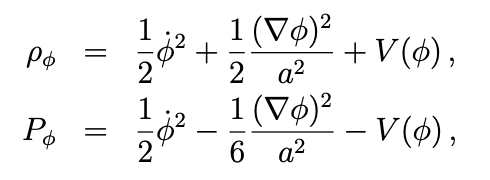

A minimally coupled scalar field is easily shown to replicate a cosmic fluid. But can it account for the cosmological redshift?
A minimally coupled scalar field can model a cosmological fluid model where
And where the equation of state can be the standard ## \omega = \frac {p} {\rho}##
I can see how this does a fine job modeling matter, because as the scale factor increases, the density will go as ##\frac {1} {a^3}##. However, is it possible for it to account for the redshift, where photon energy density goes as ##\frac {1} {a^4}##.
Last, and somewhat related questions. Because all known particles in the universe follow the energy-momentum relation, and thus the Klein-Gordon equation, is is possible to use the KG equation (or really just a classical scalar field) to model all the contents of the universe? This is what got me thinking about a scalar field reproducing the cosmological redshift.

Scaling as ##a^{-4}## requires the equation of state ##P = \rho / 3##. What do the equations you posted for ##\rho## and ##P## say? Is that equation of state possible?

Yes, and for a scalar field we have known equations for both of those; they are in the OP of this thread. So the question should be answerable for this particular case.
Shouldn't the factor in the second term of ##P_\phi## be ##1/2## instead of ##1/6##?
Yes, that was a typo.
From a simple calculation, in order for a homogeneous, isotropic scalar field to have that equation of state, the ##V[\phi]## function would have to be equal to ##1/4 \dot{\phi}^2##. It seems this would be a very strange potential function because it is of the exact same form as the kinetic. Probably a nonsensical field because if you put that potential into the Lagrangian to rework the EOM, it would just be a constant ##1/4##.
That's not possible. ##V## can't be a function of ##\dot{\phi}##, only of ##\phi##.
Makes sense. I suppose in this case then it wouldn't be possible to have ##P=\rho/3##.
That's correct. The only possibilities are ##P = - \rho## (in the limit ##\dot{\phi} \to 0##, as you said earlier in the thread), which means ##\rho## is constant (does not scale at all with ##a##), or no well-defined value of ##w## at all, because the ratio ##P / \rho## does not give a constant but varies from point to point in spacetime.
