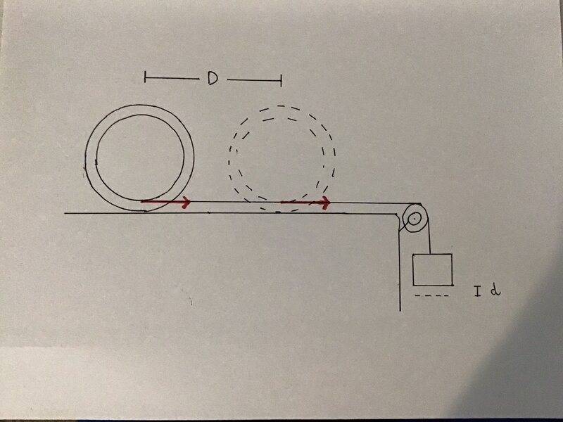

leafy said:
Here I drew the the system. The cylinder moved a distance D at a later time. The force (in red) moves the object for a distance D. The weight on the right also displaced a smaller distance d.
work done by the weight = mgd
work done on the cylinder = mgDView attachment 294549
leafy said:
Let's say I was pulling the string. I felt a tiny displacement. So my work done is the force I pull times the displacement my hand made. On the cylinder end, the same force carry by the string, but the displacement is many times higher. The work done is then force time big displacement. Obviously, the energy doesn't add up.
Using your well drawn diagram, it seems to me that combining D and mg is not correct.
The force doing effective work should be the one applied to the center of mass of the cylinder, which is the effective distance represented by D.
The magnitude of that force is smaller than mg, as many times as the distance of each force to the contact point with the table is different.
If you replace the cylinder with a lever pivoted at the table, you could visualize that you are losing force intensity at D, as you have less and less mechanical advantage as you apply resistance to mg higher and higher.

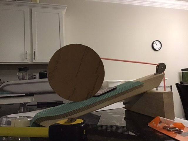

  • #36
Thanks guys. I did the experiment and measurements. And the result is conservation of energy win, again. Efficiency is around 40s%. I turn the wheel upside down and efficiency doesn’t change much. So yes, you guys are right. Sorry giving you a hard time Dale. I should have done this before discuss things. Oh well,
Someday I’ll beat CoE.
