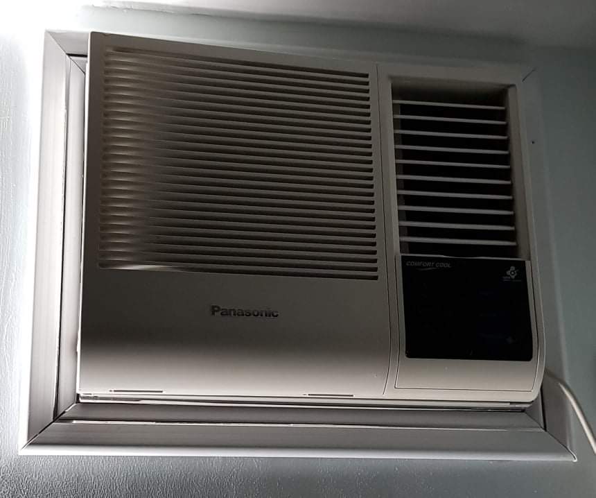

I read before that room air conditioner is not supposed to suck in air or particulates/dusts from outside but my air quality monitor can detect some increase in pm2.5 particulates when the aircon is opened. Is it because its sucking those particulates from outside or the fan of the air conditioner recirculating the dusts within the room?
This is s 3/4 horsepower window air conditioner:
Unless your air conditioner has a "Recirculate" setting, I would think that all of the air that it pumps in would be outside. Where else would it get it from?

My aircon design is just like the one posted by hutchphd. Mine doesn't have any recirculate button nor any filter.
I think the unit outside and inside air compartment is not so air tight hence still acquiring air from outside? Or maybe the dusts in the room is recirculating especially near the ceililng? My electric fan is small and I can't hang it in the aircon level to test.

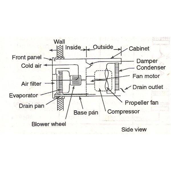

Some window AC models have intentional ventilation, which uses an adjustable damper that allows fresh air intake.
As the picture shows, it takes advantage of the relatively low pressure created between the air filter and the suction end of the blower.
You may be able to determine if your unit has that feature via visual inspection.
If it has it, check the condition of its soft seal, as well as either or not the damper is fully closing as commanded to do so.

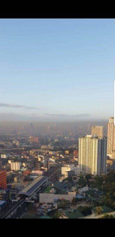

There are more particulates outside because I'm also using an air purifier. The outside particulates is like this:
It's about 20ug/m^3.
It's only 2ug/m^3 in my room. Turning on the aircon makes it 3ug/m^3. An increase of 1 ug/m^3.
If my air purifier is turned off. The room pm2.5 slowly increases as the mist outside diffuses in.
Before last christmas when my cousin gave an air purifier to my parents as present. I didn't even know that without any visible pollution like in the street cars exhaust. There is still pollution even at 35th floor that can diffuse into bedroom. Most didn't know this hence there is no greater awareness to fight against pollution by the public.
I don't know if the aircon blows the dusts around the room or there is some damper in the aircon. I'll test more.

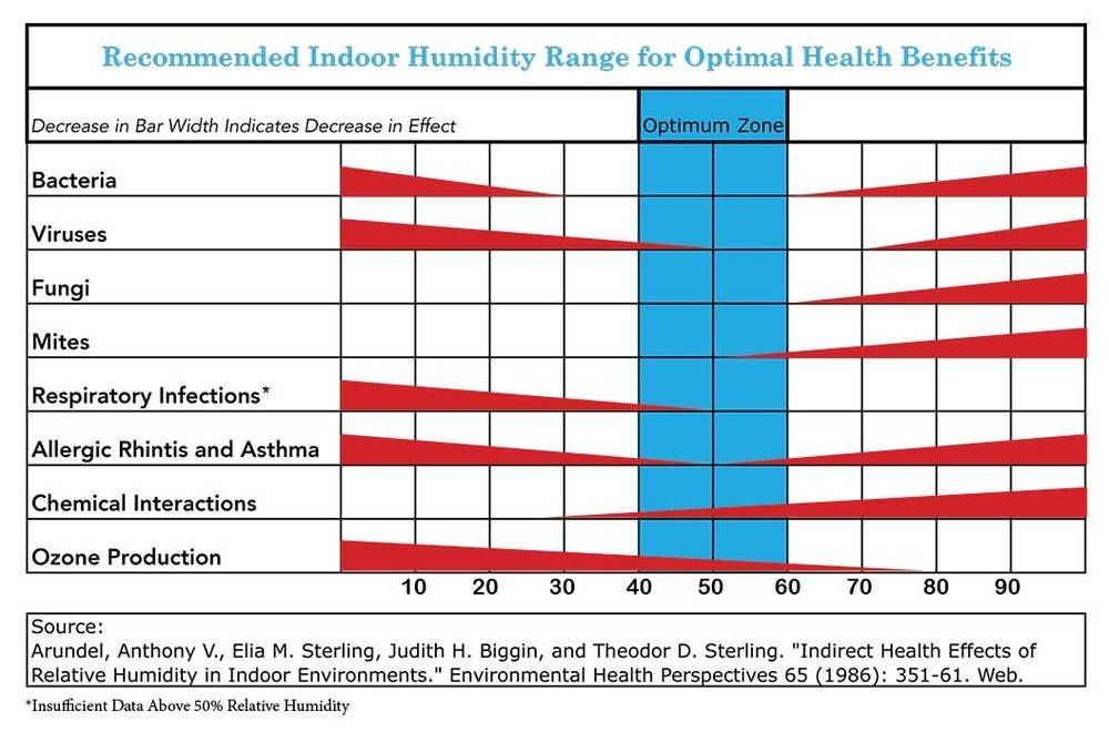

See why flu and probably Coronavirus are winter diseases?
That settles what to get. An air conditioner that can make the room cool instead of just a dehumidifier that can make it a bit hot. Thanks.

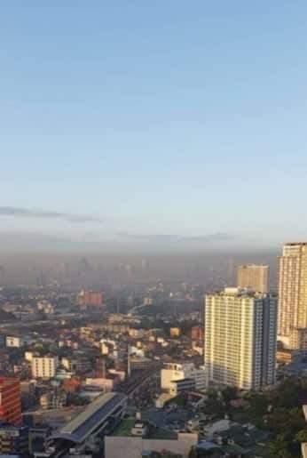

I wonder if humidity levels are related to the levels of the particulates. The humidity is low today. This is the pollution mist or haze when our Coronavirus positives were only 3.
This is when the Coronavirus positive counts increased to 49. The air becomes very clean because of few vehicles in street. All schools closed. Many don't go out. It's taken both early morning at about 6:30AM.
This is first time I get a very low pm2.5 reading. You can look into the far horizon. Air is just so fresh. This should be what cities should look like.
For the rest of the world. Try to notice the pollution is less now. I saw maps of china. It showed much lower pm2.5 levels too during the lockdown.

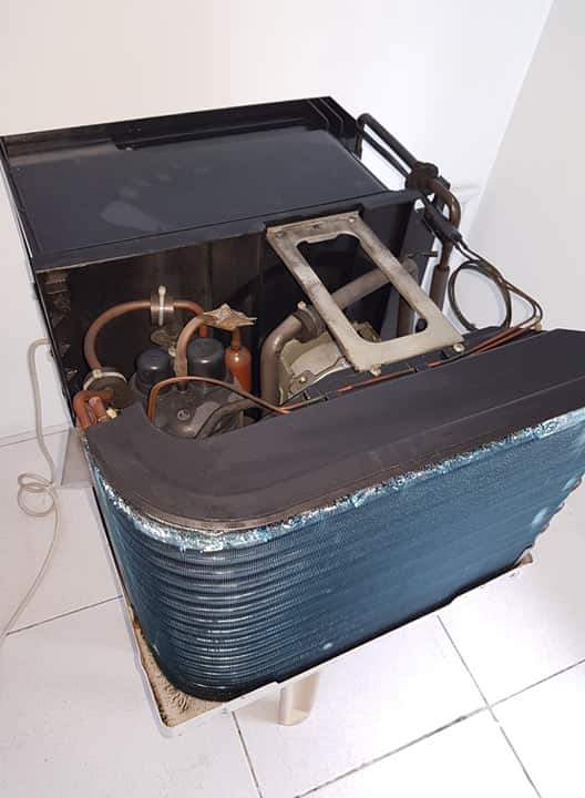

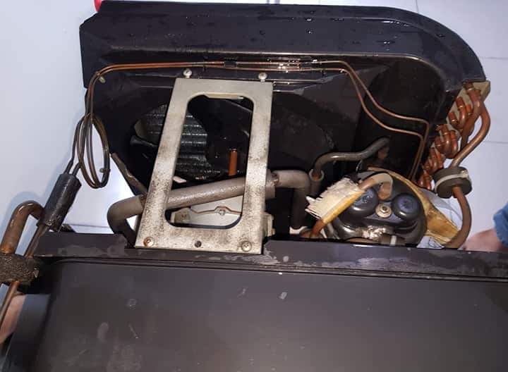

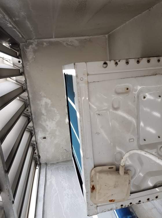

This is the internal of the air conditioner when I asked for cleaning service today. I can't find any damper. Maybe when the condensor fan is running. It can send some air from the sides to the inside?
