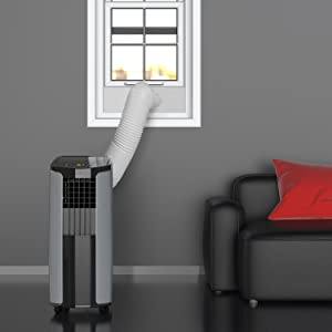

The only thing I can imagine is that a mfr can advertise a higher BTU/hr figure.
So, I picked up a used single-hose portable a/c (window is better than portable of course - and cheaper - but my back is shot and for some reason the super takes a dim view of window units on the 20th floor).
It was 31C for a few days, earlier in the week : this normally means I'm screwed without a cold sink on hand (yes, it's on the laundry list of medical issues I'm currently trying to have addressed). I was prepared for the advertised 8,500BTU/hr to be around 5k net instead : it's not a large room(12x 12'?) and should be doable.
On the one hand, the room went from 90F down to 80F, but I was looking for the ability to drop it down to 65F, or so (enough wiggle room that I can count on 70F : a comfortable sleeping temperature for yours truly).
It's not (or at least doesn't appear to be) a faulty unit - the air coming out of the vent is cold enough - but, the fact that the damned thing is actively exhausting warmed room air to the outside at about the same rate it's providing cold air is pretty annoying. Also, within context of an apartment building, 5/6 sides of the room are non-radiative into nighttime relative coolth.
I'm going to DIY the thing into a two-hose for the obvious reason, having the requisite amount of cardboard and duct-tape on hand to build a plenum for the short length of 5" hose I'm going to use. It does appear to have two inlets for air (two grills; one has a filter, behind it). But, that's probably next week's post.
Meanwhile, the mystery I'd like to solve is "Which idiot designed this thing ? and in what context would it actually be useful ?"Thanks
It's not clear what you mean. Is this an evaporative cooler? Can't you just vent the warm air out the window?
The pic is similar to the unit I have. That's an actual air-conditioner, not a swamp (evaporative) cooler.
With the two-hose models, outside air is inletted, warmed and exhausted to the outside ; inside air is cooled.
With the one-hose models, the inside air is used to dump heat to the outside, thus only one hose is necessary.
Comparison
I'm honestly trying to figure out how the one-hose a/c's got past design quality-control.

The problem is that if you exhaust the hot air to outside, you need to bring in make-up air from somewhere, otherwise you will deflate the room. So yeah, they're not great.
That makes sense. Thanks. So I presume window units reject the heat using already outside air just like my AC compressor at my house. Now I get what hmmm27 is planning to do, to turn a one hose into a two hose.

You are correct - an AC unit and dehumidifier are basically the same device. So if you need cooling, it is best to locate the condensing unit outside (a normal split system air conditioner), so it isn't rejecting the heat into the room.
I conclude its still worth it since the dryer air will feel cooler and will actually cool more efficiently in the central AC.
This is unlikely. Yes, it's probably more efficient than an AC unit in a certain way of measuring (heat movement at the coils), but the heat rejection into the room means you need another way to cool the room otherwise the overall feel will be hotter. In other words, the cycle itself is more efficient if you use the same equations, but the math doesn't "know" the heat is being rejected into the room. If you instead measure efficiency based on heat movement for the room, the efficiency of the dehumidifier is negative. It's heating the room instead of cooling it, and it is unlikely to even "feel" cooler for being dehumidified.
