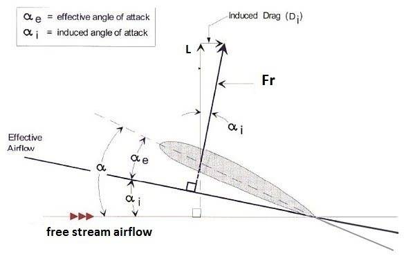

Theory predict downwash that will cause reduction in airflow angle,this we call effective airflow(airflow with lower angle compare at geometric AoA). Does wing of aircraft during flight really "feels" this effective airflow or this is just mathematical manipulation of reality, the way how fit numbers with experimental results?
Diagram of an airfoil showing the free stream airflow, the tilted effective airflow, the effective angle of attack, the induced angle of attack, lift L perpendicular to the free stream, and the resultant force Fr tilted backward with induced drag Di.

Yes, there really is an additional velocity component that reduces the effective angle of attack of each wing section, and it's dependent on the wing shape and aspect ratio. One fairly easy way to show this is that not only is the lift slope of the wing reduced for a low aspect wing, but the stall is also delayed, which you would only expect if the wing is genuinely experiencing a lower actual angle of attack. You can also use pressure taps around a model or aircraft and measure where the stagnation point is, which also demonstrates the reduction in AoA.

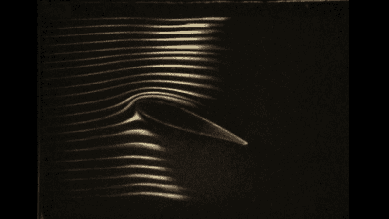

I am confused about the question. I thought that the airflow in a wind tunnel showed that the AOA actually increased due to an upward flow just ahead of the wing. Everyone here is agreeing that it decreases. Can you clarify it for me?
Schlieren photograph of airflow over an airfoil in a wind tunnel, showing curved, evenly spaced light and dark streaks bending upward ahead of the leading edge and downward past the trailing edge.
You are correct ,downwash dont exist ahead of wing/airfoil, ahead of airfoil is always upwash.
Downwash is above(from tangent to surface is horizontal downstream),under and far long behind the wing
Downwash is above(from tangent to surface is horizontal downstream) ,under and very short behind the airfoil.
Upwash is always ahead wing or airfoil.
Also downwash is stronger above/under the wing compare to airfoil.

I never said downwash dont exsit, I just said downwash dont exist ahead of wing and vortitces behind the wing cant induce vertical velocity infront of wing. "wet road dont cause rain"

There is upwash ahead of the wing, but "angle of attack" is usually referencing the freestream so it's just considered part of the way the wing itself is affecting the flow.
What's being discussed here is specifically 3d flow behavior, and how, compared to a 2d airfoil section in a wind tunnel, you end up with a bit of downwash when looking at an inboard section of an actual 3d wing, and that effectively tilts the entire flow (as pictured in your image of streamlines) slightly downwards.

No, once again (and your own video agrees with me), a real 3d wing experiences some downwash, and the shorter the aspect ratio, the more intense this is.
