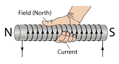

Is it possible to create an electromagnet with one continuous wire with 2 like poles (i.e. both ends either north or south)?.
Visualising it with the right hand screw rule for current carrying coils, it will be like the picture below, but one end of the coil will be as shown, while the other end of the electromagnet will be coiled in the other direction as dictated by the right hand screw rule pointing to the right, to give both extreme ends North, with 2 South pole ends in the middle.
Right now in my head it seems possible to create this kind of electromagnet, given that i can find a way to keep the coils from messing up when a current passes through it.
Is this actually possible? What are some complications that you may foresee or ways to make it work if it can't?
Thank you so much.
Looks to me like you could reverse the direction of the wire as it wraps around at the midpoint. But then you have a very large repulsive force between the two parts of the coil.
that's what I'm thinking too, but it seems plausible so far
Think about the flux in the centre of the coil. As you bring the two halves together they will tend to cancel each other.
You can't have a north pole (or poles) without a south pole somewhere. This is true no matter what kind of magenet you are talking about: permanent, electro-, or hybrid. Once the position of the poles is specified, then one can think about where the wires go.
I was under the assumption that the south poles would be in the middle and the field would look similar to placing two bar magnets together with their south poles touching.
You will discover that a "pole" mid-magnet gives you very weak poles at the ends.

Thank you all for the responses.
Can you please elaborate more on why that will happen? My grasp of magnetism isn't that strong. :/
