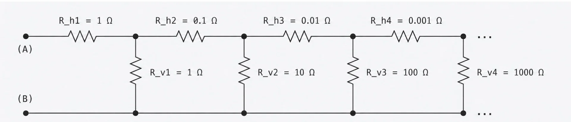

An infinite resistor ladder is given in one of Paul Nahin’s books* and he asks the reader to find the exact solution. I believe there is no closed form exact solution as a single rational number.
The circuit looks like this;
I used LTSpice simulations, hand calculations and other tools to compute the equivalent resistance of this ladder and to see it converge toward a solution but found no exact closed form solution. I believe the exact solution is an irrational number but I can’t prove it. Note that if one only computes to a few decimal places one might think it’s a repeating number as professor Nahin suggested in his book in which he freely admits he did not know the answer but instead challenged the readers to find one. Of course this is to be taken not as a practical exercise but more a math exercise.
* Mrs. Perkins’s Electric Quilt (challenge problem 3.4)
I get ##R_∞ =1.900991080179287315…##

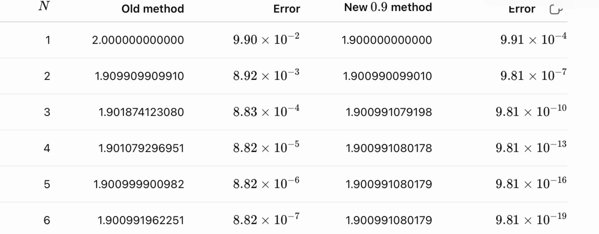

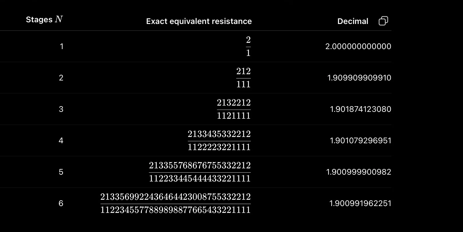

Thanks. In looking at the exact solutions for the first few terms it seems the fractions quickly get gigantic.
These seem also to have no common factors so each fraction cannot be reduced. I suspect this pattern continues as ##n→∞## we get an infinitely large fraction which cannot be reduced.
Also, I believe not all infinite ladders have to have irrational equivalent resistances. If in the ladder above, the horizontal resistors are all 4 Ohms and the vertical resistors are 3 Ohms, the equivalent resistance is 6 Ohms.
If you can evaluate the exponential ladder as a fraction, p/q, which you can, then the result must always be a fraction, and so the result should always be rational.
Then comes a problem, that you must evaluate an infinite number of terms, so p and q will each have an infinite number of digits, and the evaluation process will take longer than forever.
It seems there are few or no common divisors between p and q, so the numbers do not collapse.

bob012345 said:
TL;DR: An infinite resistor ladder is given in one of Paul Nahin’s books* and he asks the reader to find the exact solution. I believe there is no closed form exact solution as a single rational number.
The resistance between points A and B can be expressed in the form of the infinite continued fraction. $$ 1+\frac{1}{1+\frac{1}{0.1+\frac{1}{0.1+\frac{1}{0.01+\frac{1}{0.01+\ddots }}}}} $$

We know that a ladder network can be solved as a rational fraction, p/q, however that cannot be done with an infinite exponential ladder, so we need an approximation. Each time we add one more step, to get a closer approximation, that would increase the number of digits in p and in q, but as a truncated continued fraction, the approximation would remain rational.
So, instead, we consider a limit. How do we know that the limit is irrational?

For the original infinite ladder in post #1 I have found that the number of digits in ##p## and ##q## goes as ##1+n(n-1)## as in post #5 above.

Doing that derives the limiting term as ##0.9⋅10^n## discussed in post #8.
You're right, I missed that in my earlier comment. I was thinking along the right lines with the recurrence, but I overlooked the result you had already derived in post #8. Thanks for catching that. I'll go back through the derivation before commenting further.

And $$P_1-P_2=q^2+q+1$$ thus ##R_2=\large\frac{2q^2+q+2}{q^2+q+1}=\large\frac{212}{111}## since ##q=10##
