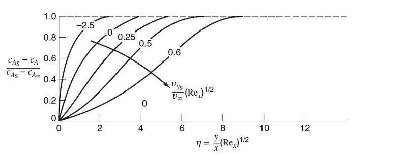

I was given a plot and a citation, but not too much clarification on what it represents. I believe it is describing mass transfer in a boundary layer.
Can anyone clarify
J. P. Hartnett and E. R. G. Eckert, Trans. ASME, 13, 247 (1957).

I think it represents mass transfer in flow past a flat plate in which mass is also being introduced by flow through the porous plate.
