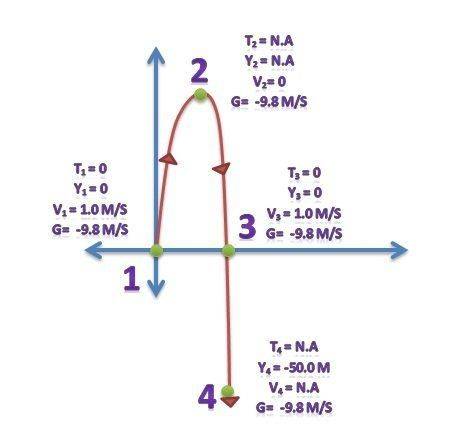

A scaffolding is rising at 1.0 m/s when at a height of 50.0 m , then the man on the scaffolding drop a can. determine:
a. the time needed for the can to reach the ground .
b. what is the final velocity ?
note: g=-9.8 m/s
the letter o in the equation stands for initial example : Vo( initial velocity) .
V=Vo +(-g)t
y=yo + volt + 1/2(-g)T^2
V^2=Vo^2 + 2(-g)(y-yo)
y-yo=(v+vo)/2 (t)
t = time
y=position
v = velocity
g=gravity
The illustration was illustrated by our professor .
the attempt that i was trying to solve is i tried to get each of all the final velocity.
guys can you help me on how to solve this ! thank you !

sir yes ! a= g . and the g is equals to -9.8 m/s^2
sir ! how many times should i compute for the time ? is it 1 time or 4 times ? base on the illustration ?
If you insist on g being negative, then your formula is incorrect. (It has a -g in it.)
Why not just once? Solve for the final time when it hits the ground. What values will you put for y, y0, and v0?

sir ! our professor says that it is always negative . so he is wrong ? and the right is -g=9.8 m/s^2 ? right ? thank you ! so sir we will disregards the illustration ?? and compute the final velocity just once ?

ah i see sir ! thank you. sir so i will disregard the illustration that our prof was made ? and i will focus in solving using the given value's in the problem ?
I suppose the illustration is there to help you visualize what's going on. (I think the velocity at point 3 should be negative.) But you can solve for the final time in one step, you don't need to solve for all the intermediate points.

so sir. i will be focus on the formula that u was given to me ?
Yes.

:confused: Why didn't you use the formula I indicated in post #2?
sir i derived the formula that you indicate like what i saw in my lecture .
You posted some formulas. I quoted one and said "use this one". So use it. (The one you derived assumes that the initial speed is zero.)
