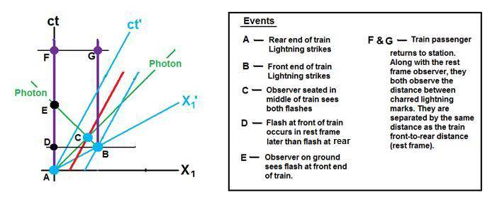

I'm not sure this space-time diagram is very easy to follow, but it attempts to depict an observer riding in the middle of a moving (relativistic velocity) train car (represented by the red slanted line). The frame of reference for the train and rider is represented by the blue coordinates. Another observer is standing by the tracks in the black rest frame as the train passes. Lightning flashes simultaneously at the front and rear of the train car in the blue frame of reference. However, the flash at the front of the train is delayed in the black rest system.
The train tracks are charred adjacent to front and back of train at the lightning flash events. These charred marks are represented by the two purple vertical lines in the sketch.
Notice in this space-time diagram the train tracks extend indefinitely along the X1 direction (for both frames). To show the whole track in the diagram you would have to start with an extended line along the X1 axis and then extrude it along the 4th dimension, essentially covering the whole screen with whatever color you choose to represent it. So, I just left the screen white for the extruded steel track. But, I wanted to show explicitly the purple charred marks as they extend into the 4th dimension.

I'm not sure if you can read the post #11 space-time diagram, but it is clear that both light flashes arrive at the middle of the passenger car at the same instant (the two photon world lines intersect at the middle, right where the observer is sitting).
bobc2 said:
...But, I wanted to show explicitly the purple charred marks...
I'm not quite ready to get into the side question that I'm about to ask, but the horizontal distance between the blue lines is the length between the moving char marks, while the horizontal distance between F & G is the length between stationary train's char marks as well as the track char marks? Did I get that right?
I´ll have to gnaw on that. This diagram seems to be drawn from the perspective that it is known that event a and event b occurred at different times and that the observer at c had experienced an illusion of simultaneity. It seems that there should be a way to also draw the events as truly simultaneous on the timeline and also received at the same time. I guess that would be equivalent to redrawing it from the perspective that the train is stationary and the tracks are what is moving. Thinking...

...the horizontal distance between the blue lines is the length between the moving char marks
Yes. Char marks were made at the front an rear of the moving train (it's also the distance from the rear end of the train to the front of the train).
kwestion said:
...while the horizontal distance between F & G is the length between stationary train's char marks...
The train is not stationary. The vertical purple lines are the char marks on the stationary tracks extended into the 4th dimension. However, once the train stops, then the distance between front and rear train char marks will be the same as the F to G distance.
kwestion said:
...as well as the track char marks? Did I get that right?
Got this part right. Track char marks are staionary, therefore the 4-D picture of the char marks are two purple lines extended vertically into the 4th dimension of the rest system (black coordinates).
To repeat the point about the observer sitting at the middle of the train passenger car: Notice that the photons arrive at the passenger's position at event C simultaneously. The observer on the ground would agree on that as well (ground observer agrees that the passenger witnessed both flashes simultaneously--that is, the ground observer agrees that the two photons intersect at the middle of the passenger car).

They seem to be the same case described from two different frames, but it is hard to tell without seeing the full description.
ghwellsjr said:
It would help if you would quote the original author so we can know what you're talking about. Please give the whole statement of the problem and the author's solution or provide a link.
Okay, here's the story line I'm considering. Its from pages 10-12 of the book PHYSICS FOR THE REST OF US Ten Basic Ideas of 20th Century Physics by Roger S Jones.
[…] We shall again employ one of Einstein’s famous thought experiments: Imagine one observer—Stacy, let’s say—standing on the platform in a railroad station while a train is passing by. As luck would have it, two lightning bolts strike—one at the front end and one at the back end of the train—as it passes Stacy. Fortunately, no one is hurt, but the lightning leaves telltale char marks at both ends of the train and also at two corresponding points on the platform. Stacy takes advantage of the situation to make an observation. She notices that the light from the two bolts reached her at the same instant. She then paces off the distance between her point of observation and each of the char marks on the platform and discovers that the two distances are equal. In other words, Stacy was exactly equidistant from the two ends of the passing train as the lightning bolts struck. What does Stacy conclude?
Stacy received the light from the two lightning events at the same instant. The distances between Stacy and the two events are equal, and the speed at which light traveled to her from the two events is, of course, the same. So the two light signals Stacy received traveled equal distances in equal times and reached her at the same instant. The two original events (the emission of the light by the two bolts) must have occurred at the same time, and therefore they were simultaneous.
There seems to be nothing too surprising in all of this. As far as Stacy is concerned, two bolts struck at equal distances from her, and since she received the light signals at the same instant, the bolts must have struck simultaneously.
Let’s now look at the same two events from the point of view of an observer in the reference frame of the moving train. Our second observer will be Trent, who is located at the center of the train. Because Trent is moving with the train, he is approaching the light signal that travels toward him from the front end of the train. He’s also moving away from the light signal that proceeds toward him from the back end of the train. Thus Trent first intercepts the front-end light signal, while the back-end light signal is still catching up with him. An instant later in time, he receives the back-end signal.[8]
Afterwards, Trent also paces off the distance between his point of observation and the char marks at each end of the train. He, too, finds that the two distances are equal.[9] What then does Trent conclude? He is equidistant from the two events, and the speed of light is the same for him as it is for Stacy. (Here is where the crucial second postulate comes in: the speed of light is exactly the same in the train and in the station reference frames.) The two light signals traveled equal distances to Trent in equal times. But the light from the front event reached him earlier than the light from the rear event. Therefore the front event must have occurred earlier than the rear event.
The two events that are simultaneous for Stacy are not simultaneous for Trent. Stacy claims that the two bolts struck a the same instant; Trent says they occurred at different times. Who is right?
Einstein's surprising answer is that they are both right.[...]
Edit: the author also had some footnotes in this section that I am now later adding:
[8] The time delay between these signals will admittedly be very small because of the height speed of light. But we can imagine that Trent is also moving at a very high speed-- half or three-quarters of the speed of light. In any case, there is a time delay, no matter how small, as long as Trent is moving.
[9] The equality of the two distances that Stacy and Trent measure is not critical to the argument; it’s just a convenience. They can infer the time intervals from whatever distances they measure. But since this is a thought experiment, we might as well keep things simple.​
I recently posted the description of the scenario that I've been thinking about. Typically, I think the two perspectives are taken to be from two different observers, in my case, I'm wondering why a single observer can't have two different perspectives on the situation.
In the above-posted story line, my puzzle centers on this statement: "[...]Because Trent is moving with the train, he is approaching the light signal[...]"
I don't see how that conclusion about Trent's approach can be reached. The light in this case offers a nice ambiguity, because both the train and platform are involved in the source of the light.
I would have expected something like this: "[...]Because Trent is moving with the train, there are two possibilities: 1) he is approaching the light signal as envisioned as being from the platform, and 2) he is not approaching the light signal as envisioned as being from the train[...]"
Thanks for quoting the original author. His story is exactly the same as Einstein's:
http://www.bartleby.com/173/9.html
I'm not sure your author made clear in his discussion preceding this story what Einstein made clear in the previous chapters of his book: the "description" of how light travels and therefore what is simultaneous according to the two different frames is not a characteristic of nature but merely a matter of Einstein's personal definition of simultaneity and the propagation of light. But otherwise, there is nothing wrong with the author' story--how could it be, it's identical to Einstein's? I would just add something that was not clear, which is that although both observers measured themself to be equidistant from the two char marks, the distances are different for the two observers. I think this point may have provided confusion for you.
Do you see the huge difference between the author's (and Einstein's) scenario and the one in your original post? Yours had to do with what the train observer could see and not what was defined about the simultaneity of the distant lighting bolts.
It's not a conclusion, it's part of the way the story line was set up. But again, you need to have the background that Einstein provided in his earlier chapters. I would suggest that you read the previous chapter of his book and then see if this story line makes sense.
You can envision any scenario from any frame of reference but if it is defined according to one frame of reference, you need to use the Lorentz Transform to envision the same scenario in a different frame of reference. If you define the scenario in a different frame of reference to begin with, then of course things can happen differently.
In relativity an "observer's perspective" is just verbal shorthand for "the inertial frame where the observer is at rest". There is no reason that an observer has to analyze a situation from a reference frame where he/she is at rest, but when you talk about the "observer's perspective", that is what you are referring to.
I don't understand your concern here. Trent's movement is not a conclusion, it is part of the problem setup. I.e. "Let observer T be an observer which is at rest wrt the train". His motion is a given, not a conclusion.
Yes, both 1 and 2 are correct.
Hmm, I think I may see a possible source of your confusion. The first sentence, in red, mentions that we will do the analysis in Trent's frame, but the third and fourth sentences, in blue, are given in Stacy's frame. And the other sentences apply to both frames.
That is somewhat confusing.
Thanks for hanging in there with me. I see that you've given real effort into understanding where I'm coming from. I appreciate that.
You've highlighted what I see as the disconnect well.
You and DaleSpam made similar comments regarding it not being a conclusion. I may not be communicating well, or may not be understanding some facet of the story. Somehow though, between post #27 and #28, DaleSpam seems to have connected to my thoughts. Would you mind reviewing those posts in case they help my outward communication more clearly?
I have reviewed chapters VIII and IX in the link that you included. Among other things, it stated this:
People traveling in this train will with advantage use the train as a rigid reference-body (co-ordinate system); they regard all events in reference to the train.
That may underscore the disconnect that I'm having as mentioned in post #28.
With that statement in mind, the story line seems to be setting up the idea that the on-train observer could (and maybe should) envision the light source as being like a point on the train and therefore correspondingly the on-train observer should not be envisioned as approaching the light in this case.
Note that I'm not trying to invalidate the other perspective that the on-train observer could envision the light like a point on the track and therefore closing in on that light, but examining an additional perspective which the story line seems to set up, but mysteriously abandon.
