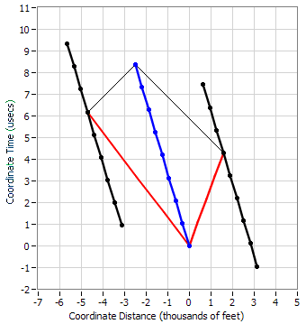

Now let's transform the coordinates of all the events (dots) in the defining frame to a new frame moving at 30%c. This makes the train move to the left at 30%c:
Spacetime diagram of coordinate time in microseconds against coordinate distance in thousands of feet, with a blue observer worldline, two black lightsource worldlines, red signal lines and thin black light-return lines.
Now the signal in the cable going to the left is traveling at about twice the speed of the signal in the cable going to the right and they reach their lightsources at different Coordinate Times and even though the light signals have different distances to travel back to you, they both arrive at your clock time of eight microseconds, just as in the rest case.

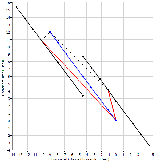

I want to do one more case at around 75%c:
Spacetime diagram plotting coordinate time in microseconds against coordinate distance in thousands of feet, showing worldlines of a moving observer and two light sources with signal paths drawn between them.
In this case, the length of the train is contracted to 4000 feet. You can see that at the Coordinate Time of 4 microseconds. The time on your clock is dilated by 50% so that the 8 microseconds that it takes for the light to reach you happens at the Coordinate Time of 12 microseconds.

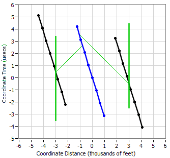

Let's imagine two probes at either end of the train that can trigger the two light sources that are some distance apart along the track in front of the train station. One probe is mounted higher than the other so that each probe can only trigger one light source. Then the only issue is how far apart are the two light sources? A naive approach might be to put them as far apart as the Proper Length of the train (the length of the train in its own rest frame). Let's assume the Proper Length of the train is 6000 feet and is traveling to the left in front of the train station at 30%c. Here is a spacetime diagram depicting the rest frame of the two light sources shown as the thick green lines placed 6000 feet apart:
Spacetime diagram in rest frame of two light sources: axes Coordinate Distance (thousands of feet) against Coordinate Time (usecs). Black train worldlines slope left, blue worldline of a moving object, green vertical lines at x = -3 and x = 3 with green light rays from events on the worldlines.
The ends of the train are shown in black. When the probe at the trailing end of the train reaches the light source on the right, it triggers the light flash shown as the thin green line propagating upwards and to the left. When the probe at the leading end of the train reaches the light source on the left, it triggers the light flash shown as the thin green line propagating upwards and to the right. You are shown in blue. The two thin green light flashes do not arrive at you at the same time and if we transform to the train's rest frame, we can see why:

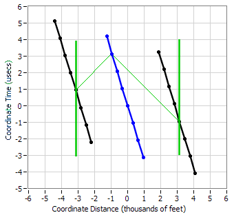

Spacetime diagram with Coordinate Distance in thousands of feet on the horizontal axis and Coordinate Time in usecs on the vertical axis. Three vertical black and blue lines mark positions at -3, 0 and 3, with thick green lines of steep slope representing moving worldlines, and thin green and black lines showing light flashes.
The reason is, of course, that the distance between the light sources is contracted and so they are not triggered at the same time in the train's rest frame but we can easily fix this by moving them further apart as shown here:

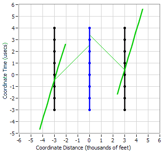

Spacetime diagram of coordinate time against coordinate distance in thousands of feet, showing light flashes from two stationary sources at x = -3 and x = 3 meeting at the central event at x = 0, t = 3.
Now the question is: How far apart must the light sources be in their own rest frame? And the answer is: Gamma (1.048 at 30%c) times the Proper Length of the train as shown here:
