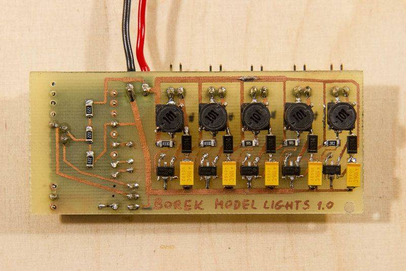

I made PCB boards at home with laser printer, thermotransfer and persulfate etching, works quite nice. Yes, it leaves some copper sulfate solution that one day I will need to get rid off (local regulations where I live are not very precise at the moment, so I can keep it here for time being).
Don't look at soldering, but this is how the etched PCB (after thermotransfer) looks like.

That's basically how the thermotransfer works and how the board above was prepared, trick is - one you have the toner on the copper it is much easier to etch, than to use dremel. I am using iron set to just above two dots (a bit hotter than for cotton) and I am heating the PCB directly, then it is enough to put the printout for the toner to be transferred (bit of pressing and massaging through some kind of cloth helps). If the paper is well selected (a thin, coated one works best, not your standard printer paper) it is pretty easy to remove it with a bath made of a washing liquid (no idea about the proportions I am using, but it is way more concentrated than what is used just for washing).
Plenty of DIY tutorials on the web.
