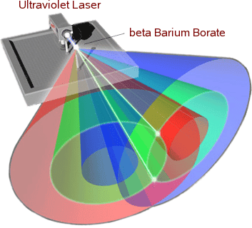

The short vs long doesn't really work like that. Due to conservation rules, the sum of the output frequencies is equal to the input frequency (of the laser). So generally the output wavelength is doubled, but that is not a strict requirement. There is also a relationship involving the cone angle, although it is more complicated. The point is that the crystal has sufficient size that the splitting does not really occur at a single, definite, well-defined position. You can read more about the process at the below links, which provide more detail than you will probably ever need to know:

The second link shows type II SPDC, which is what I was thinking of. I will read through the links you posted carefully, thanks!

My comment about the wavelengths of photons in the two cones coming from type II SPDC comes from this and similar pictures:
Diagram of type II spontaneous parametric down-conversion: an ultraviolet laser pumps a beta barium borate crystal, producing overlapping red, green and blue cones of down-converted light.
I think the change in wavelength is on the order of 10nm. From this picture, the green cone looks to be where the downconverted photons are twice the wavelength of the pump beam, and where they intersect, there is polarization entanglement. If I understand correctly, other pairs of photons are momentum, path, or spatially entangled (not sure what term is correct). So if one photon from a pair is found to be on the left side of the beam (say, where the wavelength is twice the input, just to make this easier), then it's entangled partner would be on the left of its beam. Is this an accurate model of what's going on?
