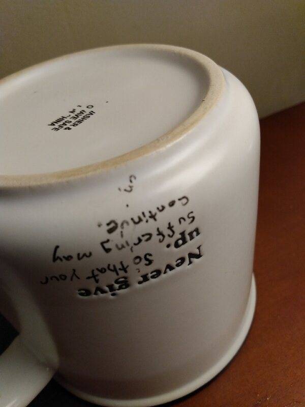

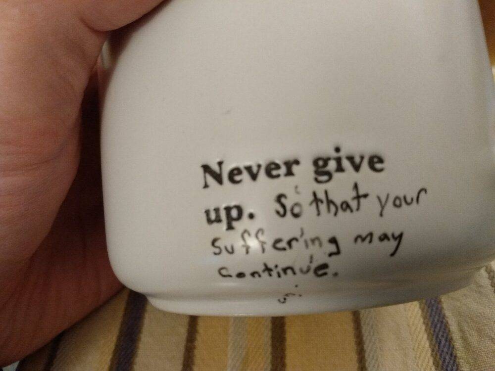

Hello. I was wondering if anyone could help me understand what just happened. I wrote a message ony mug, then microwaved water in it for coffee. I just noticed that a few letters are now duplicated below the message. It kinda looks like some moisture on the side lifted the ink up and ended up drying at the bottom, but exactly as I wrote them, no disturbance. Is this a known phenomenon?

My bet would be you touched the letters and copied them (stamped the mug) with your fingers.

No chance of that.
The 'i' appears to also be copied. The 'n' and 'u' are not aligned. That would be some fancy dancing. But I only handled the grip because it was hot.
It's not a phenomenon I've heard of. This isn't up to our usual standards for references here, but a web search turned up this YouTube video of ink on paper in a microwave, which might be a related phenomenon?
I tried it again. There was no duplication, but I may have altered the conditions. But I noticed that the drips of water stopped on the ink and hung there, and the ink was flaky.
If OP accurate, then surface ink may have behaved like a decal; peeled from the heated surface, slid down the porous outer surface of the cup, to deposit. Keep cup as unique art, but do not microwave unknown inks.

The ink doesn't look like it melted and ran down, there are no streaks.
The 'added marks' are only in one particular spot.
There actually were. It's not so visible in the pics. And I did NOT touch the ink. The i u n would all have to been touched multiple times. And it was hot.

The clearest streak is the left side of the streak, the mark above the o in So, the dotted I in suffering is actually part of o, and the streak mark at end of r in suffering to the u in continue.
I only handled the grip.I did not add the u and n at the bottom. Are you even looking?
AppleDan said:
Tulip brand fabric marker.
https://www.tulipcolor.com/bullet-tip-primary-6-pack (bolding added)
Can my fabric markers be used on surfaces other than fabric?
Tulip Fabric Markers can be used on a variety of craft surfaces such as fabric, canvas, and paper. For more crafting fun, try Tulip Fabric Paint Markers on surfaces such as denim, wood, rocks, and more.
If we say a mug qualifies as 'stone', then using a fabric marker is within specs. Problems arise applying heat and moisture.
What are opaque markers?
Opaque markers, also called Fabric Paint Markers, contain real acrylic paint in a variety of colors that are formulated to not wash out of fabric.
I used 'decal', short for decalcomania, as shorthand for a sliding or slippery (moist) surface transfer of dye. Unlike batique wax techniques to pattern fabrics, decals do not imply melting; more of a heat set.

Yeah, I think your decal explanation is perfect. When I watched the second run, that's how the flakes looked. Thanks for the insight.
