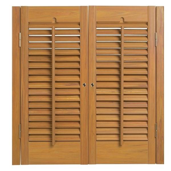

Imagine a sailboat - the sail has some similarity to a wing.
What would happen if I replaced the sail with a shutter like the one on the picture below? (Assumed the area of the shutter was the same as the sail, ribs placed vertically, each of the ribs has the shape of an air foil and the length of each rib had the same length as the mast.) Would the shutter or the sail provide the most lift/drag ratio?
I think the lifting efficiency would not be very different either way assuming the total surface area is the same.
However there could be interference effects between adjacent slats which could add to drag.
The multiple slats idea also presents the problem of there being multiple units making up the system, and thus increased overall risk of a structural failure.
More parts = more things that could fail.
Some early airplanes had multiple wings in the "shutter" configuration, but I'm not sure if any of them ever flew successfully. The big problem would be structural integrity; the one in the pic attached reportedly broke up on takeoff. Having a bunch of wings stacked on top of each other just isn't a very strong configuration. I bet it could be done with modern materials and engineering, but it still couldn't be full cantilever, so the weight and drag penalty from struts and supports would be considerable.
Another potential problem might be surface area. You'd probably get less induced drag with several small high-aspect ratio wings as opposed to one with the same planform area, but I think the total surface area of all those wings would be higher, so the increase in parasite drag might cancel it out. Someone could do the math and figure out if the surface area would really be higher (I'm too lazy to do all that at the moment ;). At any rate, this would be fun to play around with in CFD.
