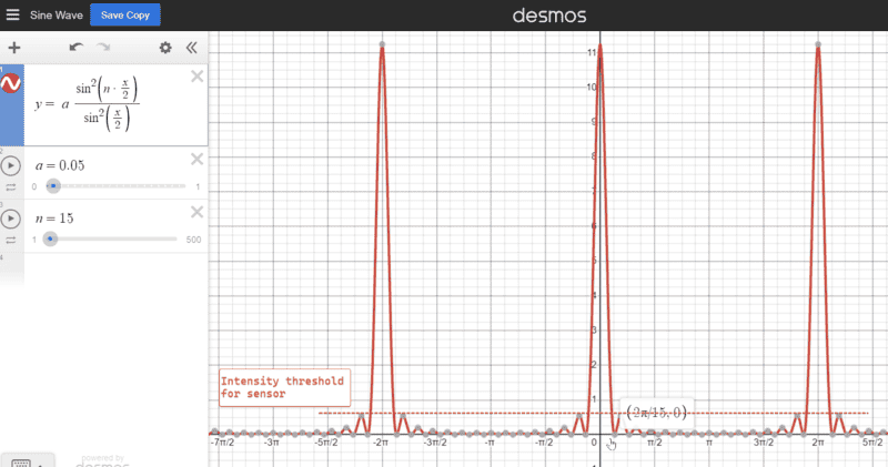

Given an imaging medium whose intensity response is only non-zero when the intensity is above certain threshold, can I cast subwavelength stripes of monochromatic light on it by an n-slit apparatus?
(the orange dash line marks the threshold intensity below which the imaging medium wouldn't respond)
Desmos graph of y = a sin^2(n x/2) / sin^2(x/2) with a = 0.05 and n = 15, showing sharp periodic peaks at multiples of 2π, with a dashed line marked intensity threshold for sensor.
It seems possible to me that if we use a monochromatic red laser with wavelength [itex]\lambda=650nm[/itex], a reasonably large [itex]n = 1500[/itex], and a reasonably small "slit-to-imaging-plate distance" [itex]r = 20um[/itex], by far-field approximation it produces a stripe width [itex]w = r \cdot \Delta \phi_{localmin} = 167.55nm < \lambda[/itex] on the presumed imaging medium.
Is there something I overlooked here that'll prohibit such subwavelength stripe?

genxium said:
TL;DR Summary: If n(number of slits) is around 1000, can we produce an intensity pattern whose adjacent local minimas are separated by a distance less than the wavelength of incident light?
Your "sub wavelength" term seems to have some special significance for you. The sin(Nx)/sin(x) type of pattern simply shows the distribution of angles at which minima can be found. Those are directions of the features of just a pattern.
If you were a radio antenna designer you wouldn't be at all surprised that there can be very tight patterns of side lobes from a directional antenna. There is no spacial significance in this.
Polar plot of an antenna radiation pattern with a large main lobe pointing to 0 degrees, a smaller back lobe pointing to 180 degrees, and many small blue side lobes around the origin, with labels for each lobe type and angle markings at 0, 90, 180 and 270 degrees.
You need to think where you could actually measure this pattern. The pattern you have calculated is essentially a far field (Fraunhofer diffraction) pattern. The width of your multiple slit array would be much greater than a wavelength and you'd need to be a long way away to see your minima - many wavelengths away - and the separation of the minima would be larger than the wavelength of your light / radio / sea waves / (and probably gravity waves, if you could make the equipment).. In close, there would be a different (Fresnel) pattern.

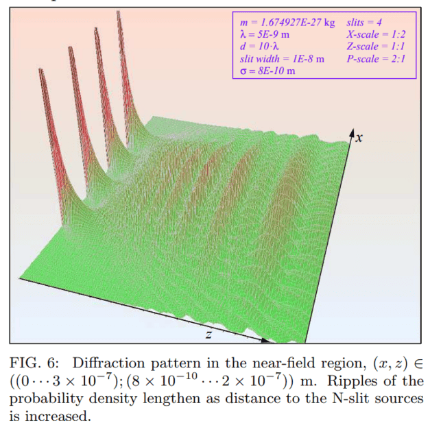

I used to put some efforts into searching for a near-field intensity formula of the n-slit apparatus, and come across something useful like this paper (which does contain examples like an aperture or a convex lens, but not the n-slit) and later this other paper (which contains exactly the n-slit).
From the second paper, it seems like there're still some nulls in the pattern predicted by the near-field model
Density plot of the Talbot effect from an n-slit source: grey-scale interference fringes spread rightward from six evenly spaced slits on the left axis, with violet Bohmian trajectories overlaid. Horizontal axis labelled in multiples of d from 0 to 8d.
, and even if there were no null I'm happy to see that the peeks are easily distinguishable by drawing a certain threshold.
3D surface plot of near-field diffraction intensity from four slits, showing four sharp red peaks at the left edge and rippling fringes extending along the z axis, with axes x and z.
The total width of the array is many wavelengths so is the result a surprise? The relevant condition for 'stripes' is not the absence or presence of nulls but a variation of resultant amplitude. What you can see in "Fig 7" is a variation in amplitude of the resultant. I would say that having no variation in the Fresnel patterns would actually be very unexpected.
So the sums look right and the result is not unexpected.
You have to be careful when looking at the result image. There is zero amplitude in between the slits because of the individual slit pattern (2 wavelengths wide), which will launch no energy parallel to the surface. I couldn't see any numbers for the resultant amplitudes of the pattern close in and the density of the blacks and greys is not specified. The troughs near-in are very low level and are spaced by less than a wavelength but they do not represent, in themselves, a travelling wave; they are the result of a number of waves, adding vectorally.
