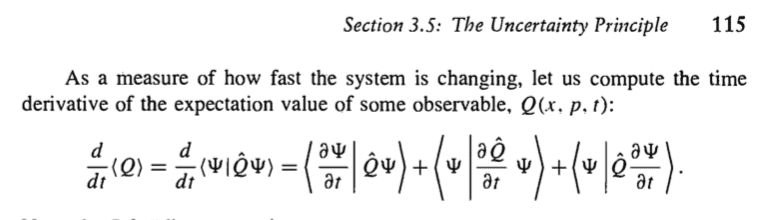

Suppose Q=2x+t and x=t2, then ∂Q/∂t=1.
But Q can also be written as Q=x+t2+t, then ∂Q/∂t=2t+1.
We now have 2 different answers. But I think there can only be one correct answer.
In reference to the equation in the image, no matter we write Q=2x+t or Q=x+t2+t, <Q> should be the same, so the LHS should be the same. But when we have 2 different answers for ∂Q/∂t, the RHS would not be the same. So we have a contradiction.
Q is an observable of a quantum system. LHS stands for left hand side of the equation.
  • Printed textbook page, Section 3.5 The Uncertainty Principle, page 115. Text: 'As a measure of how fast the system is changing, let us compute the time derivative of the expectation value of some observable, Q(x, p, t):' followed by d/dt<Q> = d/dt<Psi|Q|Psi> = <dPsi/dt|Q|Psi> + <Psi|dQ/dt|Psi> + <Psi|Q|dPsi/dt>.

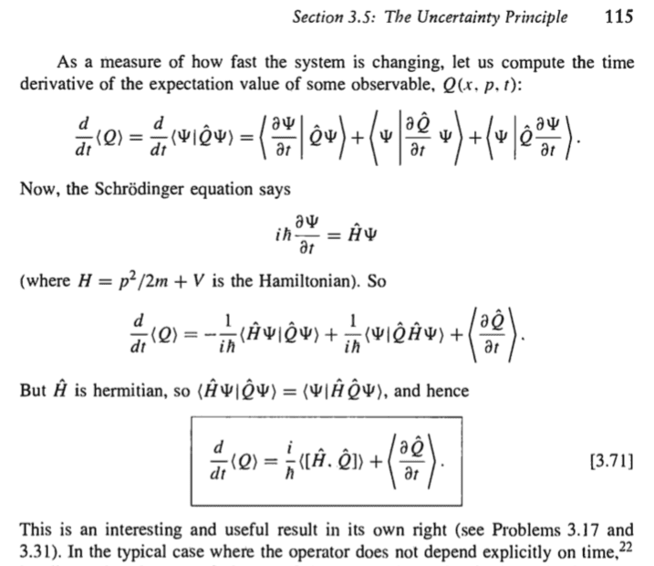

∂Q/∂t refers to the partial derivative, not the total derivative. The book goes on to talk about operators that explicitly depend on time (see attached images).
In doing the partial derivative ∂Q/∂t, we do not care about how x depends on t, but only how Q explicitly depends on t.
But no matter how you write Q, <Q> and hence the LHS should be the same, while the RHS are not the same, hence the contradiction.
  • Textbook page, Section 3.5 The Uncertainty Principle, showing the time derivative of an expectation value expanded with the Schrodinger equation and ending in boxed equation 3.71: d<Q>/dt = (i/hbar)<[H, Q]> + <dQ/dt>.

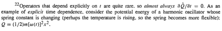

  • Printed textbook passage, numbered 22: operators that depend explicitly on t are rare, so almost always ∂Q/∂t = 0. Example: harmonic oscillator potential Q = (1/2)m[ω(t)]²x² with a time-varying spring constant.
A partial derivative is a derivative with respect to a variable where other variables are held constant. If ##x=t^2##, then ##x## isn't held constant.
Note that this has nothing to do with quantum mechanics. It is calculus. For a given ##f(x,y)##, ##\partial f / \partial y## can have only one solution.

Let's consider the Q in footnote 22 (see image).
Q=##\frac{1}{2}##mω2x2, where ω is a function of t.
Then is ∂Q/∂t = mω##\frac{dω}{dt}##x2?
Even though for simple harmonic motion, x is also a function of t (ie. x=x0##\sin##(ωt), where x0 is the amplitude), we do not care how x depends on t when calculating ∂Q/∂t. Is this correct?
I think, in quantum mechanics, it would be more accurate to say <x>=x0##\sin##(ωt). But I don't know whether this point helps in this discussion. After all, it doesn't seem to affect the value of <Q> in my original post, where Q=2x+t, so <Q>=2<x>+t. Is this correct?
(In my original post, instead of x=t2, it would be more accurate to say <x>=t2. But this doesn't seem to change the value of <Q>. So it doesn't seem to resolve the contradiction.)

Happiness said:
Even though for simple harmonic motion, x is also a function of t (ie. x=x0sin(ωt), where x0 is the amplitude), we do not care how x depends on t when calculating ∂Q/∂t. Is this correct?
That's not correct. ##x## is here the coordinate (in position representation; more generically, it would have been better to use here ##\hat{x}##, the position operator). It has no time dependence. For a quantum mechanics oscillator, its position is in its state, that is, in its wave function. What you would have is
\braket{x} = \braket{\psi(t) | \hat{x} | \psi(t)} = x_0 \sin(\omega t).
