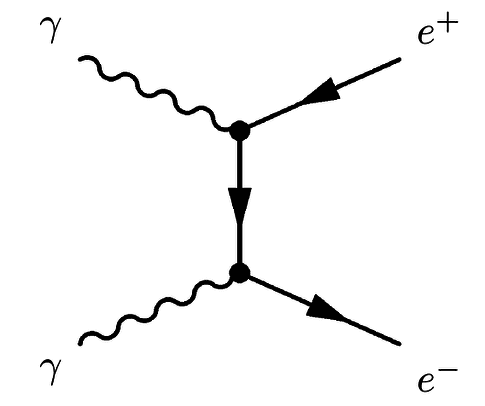

Because of the nature of the EM interaction (it is an abelian gauge theory), photons do not directly interact with one another. However, they can interact indirectly by exchanging charged particles. The simplest possible diagram is
Feynman diagram of two photons, labeled γ, colliding to produce an electron-positron pair, labeled e+ and e−, via an internal electron propagator line.
where an electron-positron pair is drawn. More generally, for energetic enough photons, more massive particles can appear in place of the electron. Energy conservation requires that [itex]E_\gamma + E_{\gamma'} \geq 2 mc^2[/itex], where [itex]m[/itex] is the mass of the charged particle.
There is no theoretical upper bound on the energy of a photon. Now the particles created can further interact or decay, leading to a more complicated final state. But the diagram above is the lowest-order and therefore dominant process for photon collisions.
  • Feynman diagram of two photons (γ) annihilating into an electron-positron pair: wavy photon lines enter from the left at top and bottom and meet a central electron propagator, with e+ leaving upper right and e- leaving lower right.
