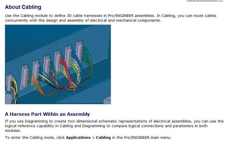

When I fired up Pro this morning, I looked in the help section so you could get a quick glimpse of Pro-Cable and RSD. I'm sure that if you do some searching you can find some more detailed info.
In my work, we have guys that are devoted to nothing but wiring harnesses, so I don't deal with it. However, I have made some rudimentary models just using the standard app and getting creative with datum points, curves and sketches.
  • Screenshot of Pro/ENGINEER help page showing a 3D rendering of multicolored cable harness bundles routed from several connector blocks across a blue assembly.

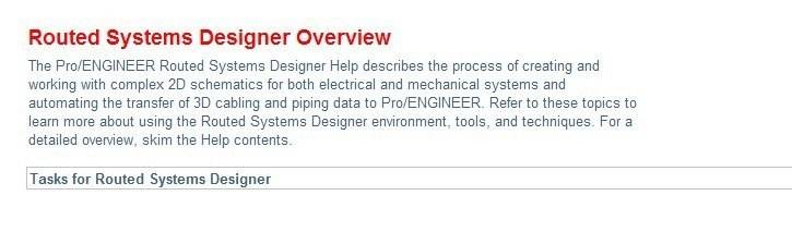

  • Screenshot of a Pro/ENGINEER help page titled Routed Systems Designer Overview, with a short description paragraph and a section header reading Tasks for Routed Systems Designer.
