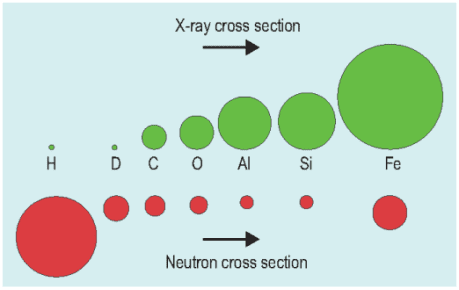

3. Neutron and x-ray scattering cross-sections compared.
Bubble chart comparing X-ray and neutron cross sections for H, D, C, O, Al, Si and Fe; X-ray circles (green) grow steadily with element, while neutron circles (red) are large for H and small for the others.
Note that neutrons penetrate through Al much better then x-rays do, yet are strongly scattered by hydrogen.
