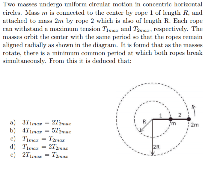

Diagram of two concentric dashed circles with a centre point; rope of length R from centre to mass m on inner circle, then rope 2R to mass 2m on outer circle, with a curved arrow showing rotation; answer options a) to e) listed at left.
F = mv^2/R
I got that T1max = T2max because when i plugged into my formula for centripetal force, i get that both ropes end up with mv^2/R which means they are equal everywhere... Is this correct?
  • Diagram of two concentric dashed circles with a centre point; rope of length R from centre to mass m on inner circle, then rope 2R to mass 2m on outer circle, with a curved arrow showing rotation; answer options a) to e) listed at left.
If the tensions were equal there would be no net force on mass 1 and it would be in rectilinear motion.
Lori said:
F = mv^2/R
You have to calculate velocities for both masses as time period is same you can get relation between velocities. Here both masses is not moving with same centripetal force
