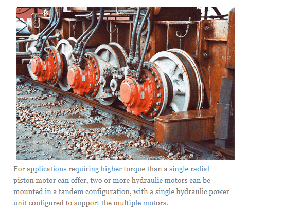

From Machine Design magazine April 23, 2015:

Chris Williamson said:
If two motors were in-line would this achieve our goal?
Provided the shaft can handle the torque.
