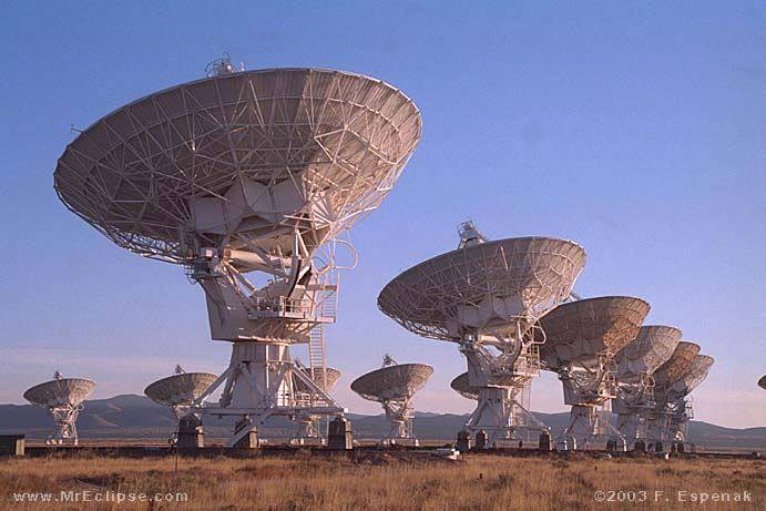

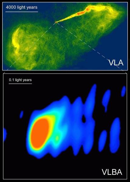

Forgive me if I'm misunderstanding what you're going for, but I'm pretty sure we've done this more than a few times, in fact - it's called a radio telescope.
M87 as seen by the Very Large Array, and the centre, as seen by the Very Large Baseline Array (image credit: wiki)
As berkeman points out: you need an antenna of the order of the wavelength of what you're wanting to image.

Yes, that's exactly the problem with a "compact camera form" - a Fourier transform means that to look at small things, you need to put your detectors far apart - this is why the VLBA looks at finer detail in the above image than the VLA. Ditto your compact camera- you need to put your antennas far enough apart (the wavelength will determine what "far enough" means) to see anything - which means it's not going to be compact.
