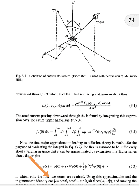

Can you please tell me the origin of this formula?

Nafis Fuad
I found this formula when I was studying neutron diffusion equation in Weston M. Stacey's book
Thanks in advance
cosβ=cosθx cosθ+sinθx sinθ cos(ψy−ψ)

How is the second line related to the first one?
Where do these variables come from and how are they related? The equation is not true in general.
Here it is
##\psi - \psi_y## is the angle between the two planes of (one vector and x) and (the other vector and x).
We can imagine ##\beta##, ##\theta## and ##\theta_r## (as drawn) to form a triangle on a sphere with radius 1, with ##\psi - \psi_y## as angle between the last two. The problem is then standard geometry on a sphere, see e.g. Wikipedia.
