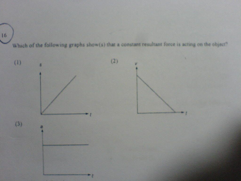

the second question is asked about resultant force. in fact, i just know it is a constant force. however, i don't know how to read these graphs.

Reading the graphs.
Graph 1 shows distance s vs. time. It has a constant slope. What is this slope also known as?
Graph 2 shows velocity v vs. time. It too has a constant slope. What is this slope also known as?
Graph 3 shows acceleration a vs. time. The acceleration has a constant value. What does this say about the net force?
This should get you started.

um..for the graphs
graph 1 is st graph, that physics meaning of its constant slope means the movin object
has a constant velocity.
graph 2 is vt graph. physics meaning of its constant slope means it has a constant acceleration.
graph 3 just like graph 2, has a constant acceleration
so i assume there is a constant force acts on a odjects,i think the motion could be represented by all of them, but ans is just graphs 2 and 3
it makes me confused><

For the graphs
What is the relation between resultant force and acceleration?
For graph 1 you are correct. So if the velocity is constant, what does that say about the acceleration? If the acceleration is what it is, what does that say about the resultant force?
You are right about graphs 2 and 3. The show that the acceleration is constant and not zero. Therefore, according to Newton's Second Law, is the resultant force is ...

oh... Newtons 2 laws state that F=ma , there will be a force when the object has acceleration, right?
constant velocity means that there is no acceleration. am i right?
Correct. When the acceleration is zero, the net force is zero. When the net force is zero, the acceleration is zero. I stress net force. An object may have zero acceleration but forces may still act on it. A book resting on a table has the Earth's gravity and the normal force acting on it and they are both not zero. However, the sum of the two (net force) is indeed zero.
At this point, and I hope I am not confusing you, I should add that "constant net force" means "constant acceleration". Zero for the acceleration is a perfectly good constant, just as good as 9.8 m/s2. So in that sense all three of the graphs show that the resultant force is constant, however only 2 and 3 show that the resultant force is non-zero.
