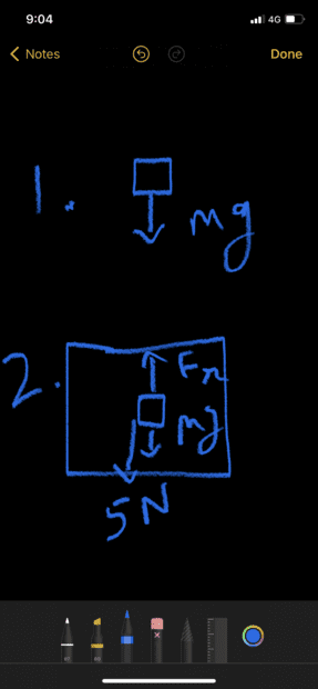

An open knife edge of mass 200g is dropped from height 5 m on a cardboard. If the knife penetrates distance 2m into the cardboard, the average resistance offered by the cardboard to the knife edge is—
##v^2=u^2+2as##
##F=ma##
##v^2=u^2+2as##
##v=10m/s##
Again ##v^2=u^2+2as##
##a=25 m/s^2##
So ##F=(200*25)/1000##
##F=5 N##
Wrong answer!
As the knife penetrates the cardboard, what forces act on it?
Gravity
rudransh verma said:
Gravity
That's one of the forces acting on the knife. And it's the one you neglected in your solution.

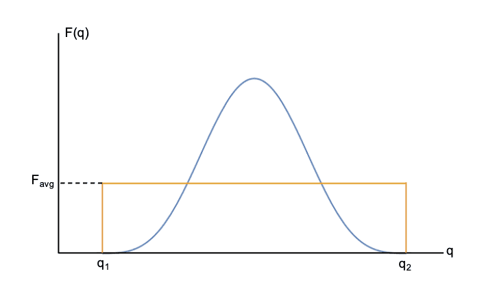

The other fault in the question is more serious in my book. It asks for the average force, i.e. ##\frac{\Delta p}{\Delta t}##, but expects this to be calculated on the basis of energy or, equivalently, ##v^2-u^2=2as##. That only gives the right answer if the force is constant. So it should instead say ”find the force, assuming it is constant ".
I don't see that. The actual acceleration is probably not constant but one can calculate the average acceleration and use it to calculate an average force. The Work -Energy Theorem does not require a constant force over distance.
@haruspex is correct on this. It is one of his pet concerns.
Suppose that we want the average force weighted by time. We certainly can calculate the velocity with which the falling knife arrives at the cardboard. Which means that we have momentum. We could divide by elapsed time until the knife stops to arrive at the average (over time) force.
But we do not know how much time it will take. The knife could slow suddenly and then sag slowly through the cardboard with an average force very nearly equal to the weight of the knife. Or the knife could zip through the cardboard and stop suddenly at the bottom.
Yes, you are correct that if by "average force" we mean a distance-weighted average then all is well. But the default meaning of average force is usually taken to be a time-weighted average.

Further to @jbriggs444 explanation, it seems reasonable to require that average force = mass x average acceleration. This makes (change in momentum) / (elapsed time) the correct formula.
It is an interesting exercise to calculate the average force during a quarter cycle of SHM by the two methods. Indeed, in many instances of questions committing this solecism SHM is more likely than constant force.
I used the two methods and arrived at the same number but when you say it seems reasonable do you mean it's really not? I don't want to be more specific since the OP hasn't had a chance to finish the problem.
Is this what you mean by a distance-weighted average force ##\int_{x_i}^{x_f} F \,dx =\bar{F} Δx##?

@rudransh verma, what two forces act on the knife as it moves through the cardboard?
How does the value ‘##F=5N##’ (which you worked out in Post #1) relate to these two forces?
That is the important part, yes. But you have to divide by total distance, of course.
Gravity at all times and friction through the cardboard.
Yes. But it is not just simple friction. It is the resistive force that is referred to as "average resistance" in the original question. Gravity (weight) and the resistive force are the two forces.
So I repeat my earlier question:
How does the value ‘’##F=5N##" (which you worked out in Post #1) relate to these two forces?
I got it @Steve4Physics If you ignore friction Then there is only one force. Due to this gravity it accelerates. And due to this acceleration there is a generation of another force. So there are actually two forces. Weight and the force due to acceleration.
So F Net= 5N + W =5+2= 7 N.
You seem to be confusing yourself thoroughly. Certainly you are confusing me.
The 5 N you calculated in the first post is the net force. So the equation you write is $$F_\text{net}= 5\text{N}$$Now that ##F_\text{net}## is the sum of two individual forces: Gravity and Friction. So an equation we can write is:$$F_\text{net} = F_g + F_f$$The net force is 5 N, not 7 N.
